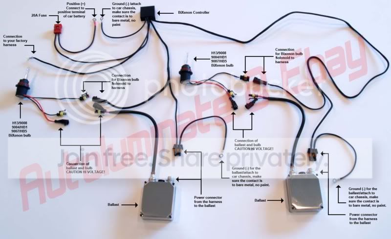

  9. supercrewzn
    7,871
    Here is a better wiring diagram
