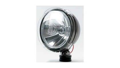

    New 100w H3 bulb. $4.88 at NAPA. Will eventually replace with HID 5000k
    Backside of housing with wire retainer
    [​IMG][​IMG]
    One wire for ground. Other wire for power. I taped them together to prevent them from getting unplugged inside by accident
    Clear Cover
    [​IMG][​IMG]
    Old Rubber
    [​IMG][​IMG]\
    New One piece rubber.

  3. ak_cowboy
    I also ordered new rubber gaskets and metal retaining cups for the mounting base.
    Total cost for all that stuff (x2) was about $30. Much cheaper than buying a new pair for $120+

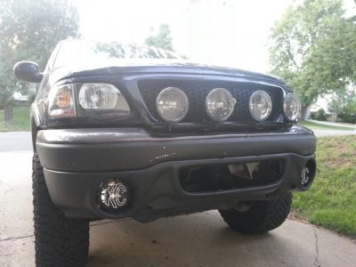

  5. ak_cowboy
    Yeah, the stone guards don't do much against the smaller rocks and Katie didn't want to redneck her jeep lol.
    [​IMG] vs [​IMG]

  8. ak_cowboy
    Lol I'll be mounting them up this weekend, weather permitting.
    The "redneck" was Katie, though I do think the clear covers look a lot more modern
