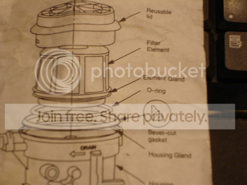

    I learned if ya don't let the filter soak up fuel first it won't seal at the lid to filter housing gasket and it will leak like a sieve.
    The filter housing to lid gasket is bevel-cut and the skinny part goes upward.
