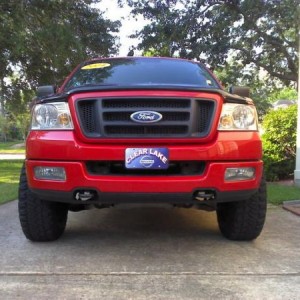

    So after talkin w/ a Firestone Tech, there is no way to adapt the 2350 kit to have a "kneeling" function. You can have it set up to air out the bags completely, but then it would only lower the suspension back to factory (the leafs would take the load). only way to get that is to replace the leafs w/ an entire air system. still think i'll be getting a set. just removing the AAL will lower the truck hopefully enough that i'm not needing a running start to get in w/ a load on my shoulder. thanks guys!

    your AAL really added that much height? mine only added like 1/2 an inch...

    43
    the AAL combined w/ the body kit has made it unbearable. and i'm not removin my BL, so removing my AAL will gain me about an 1", and then addin the firestone would let me regain payload capacity.
