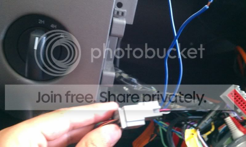

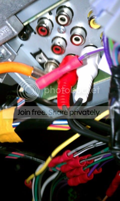

    That's what it is. Here are some pics... I hate wiring! haha
    Plug Connector
    Plugged in to respectable ports...

    Where all your speaker leads are coming from the factory harness there should be a blue and white wire.. that should be remote/amp on so if the blue wires say amp on wire them to that

    If I'm not mistaken the remote wire coming out of the head unit should be hot too.
