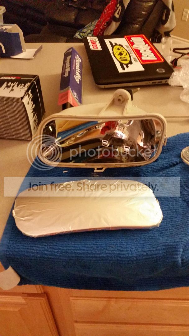

    once you have the light apart, you need to wrap the factory lens in aluminum foil, make sure there are no creases in the foil. Then preheat your oven to 330

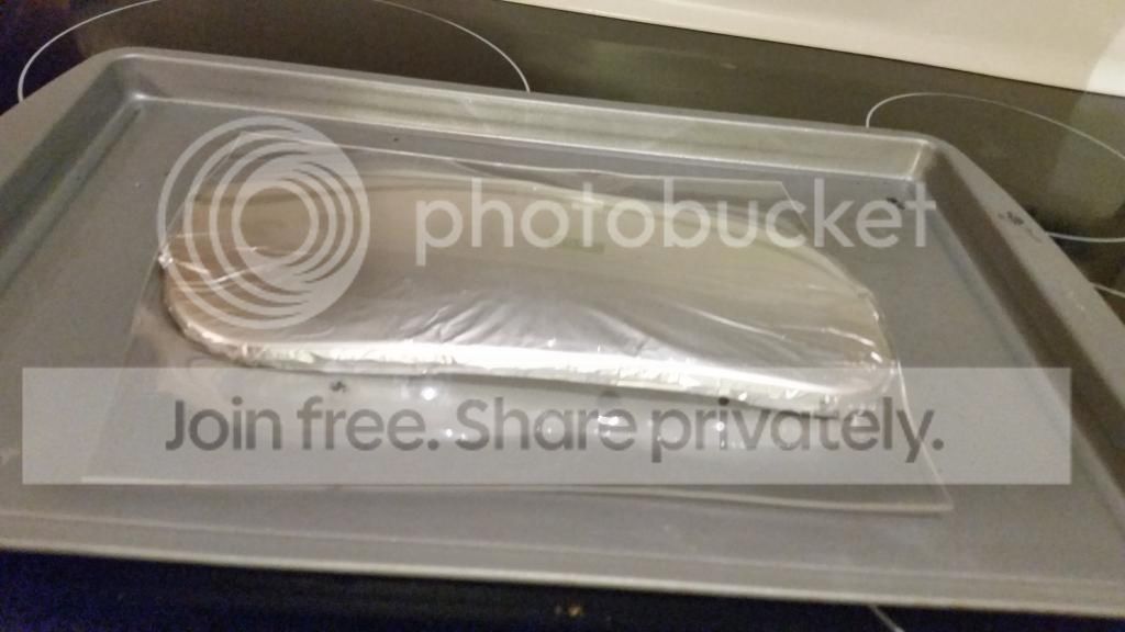

    once the oven is heated, set the factory wrapped lens in the oven followed by your piece of lexan, here time will vary as to how long it take for your lexan to form to the shape of the lense so just watch it, mine took about 9 min.
    here you can see it taking shape, once youre happy remove it.

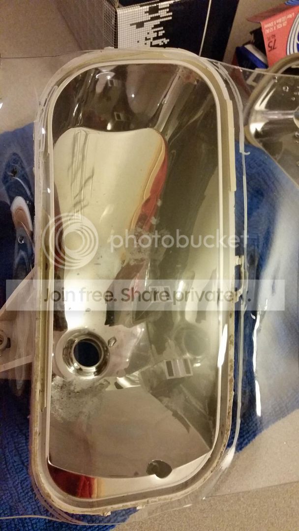

    test fitting it, you can see how its shaped just like a factory piece

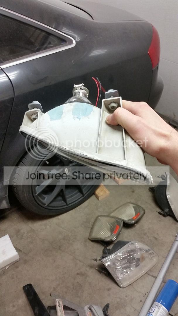

    now here is where I did my retro and painted, but you could leave youre factory chrome and just pay attention to the part about attaching the lens

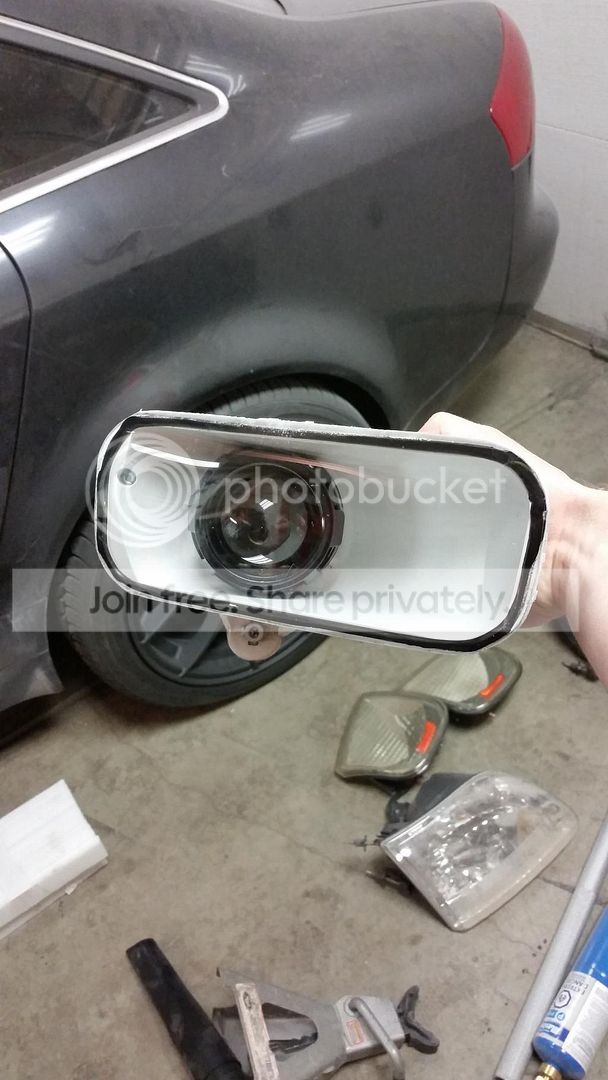

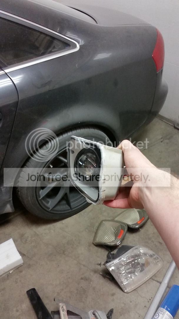

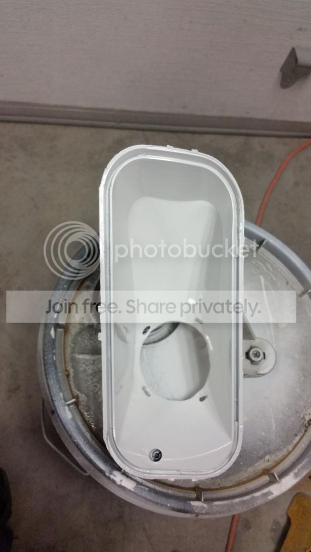

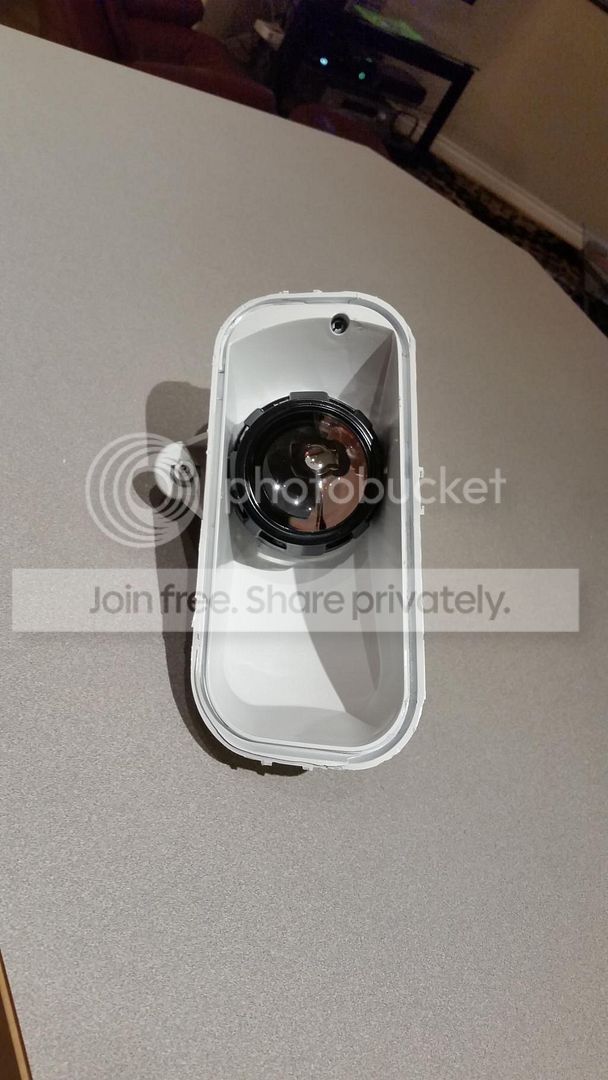

    heres my housing painted and ready
    then housing with projector

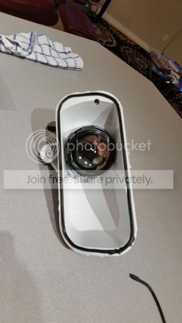

    and now the very important part, once youre ready to put the lens you made on, you place a run of the butyl rubber all around the outside, just slight larger than the diameter of the factory weatherstripping track in the housings. If you make it took big itll ooze out and become visible when you install the lights but still needs to be enough to seal well.
    then place the lens you made onto the housing and push down the edges around the butyl, then pop into the oven at 260 for only a few minutes to soften the butyl, then carefull press the edges down again, you should see a posotive seal all the way around. Also be careful touching the lexan when its heated because you can leave fingerprints, and it will be warm so be careful obviously.

  3. Roush PSD Interceptor
    Using the old lens as the template for
    the new clear lens baked @ 330°
    Brilliant!
