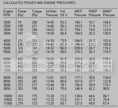

    I said 400 at the crank... 300 ish at the wheels..
    If the 347 stroker is only making 425 Done something wrong...
    Desktop dyno of my setup.. The rpms are about 500-1k rpms to high but ya get the point..

    That's what bhp is, at the crank. Not trying to be a jerk but call fordstrokers, 425-450 is really what the average 347 pulls
