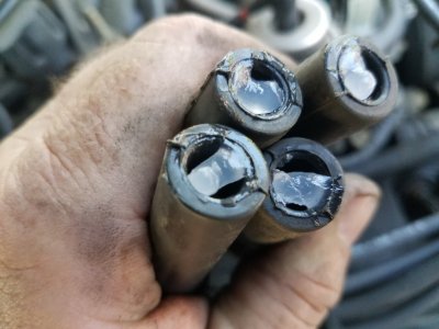

    Was di-electric grease put on the ends of the COPs
    to contacts of the spark plugs ?
    This is how I did the new wire ends to spark plug
    contacts on the 4.6L modular.

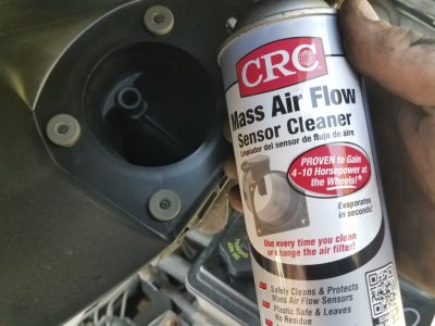

    Been a while since you cleaned the MAF with specific MAF cleaner ?
    My fren always accused me of overkill on maintenance.
    No such thing .. o_O
