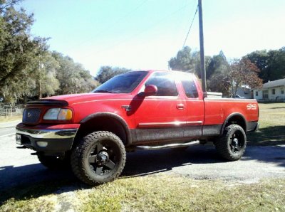

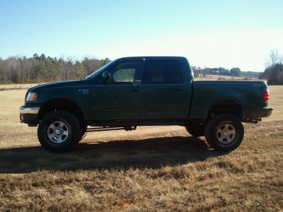

i highly disagree that a 3'' body will give you more lift than a 5'' rcx. look at the newest pic screwgreen put up it is way higher than yours or mine with our 3'' bodys.
ur gona tell me that my truck ( 3'' body and tbars cranked to almost max on 35s ) is higher than screwgreens with 5'' rcx on 35s? i dont think so... youll get a full 6'' out of the rcx and its a good noticable difference higher than a 3'' body.
