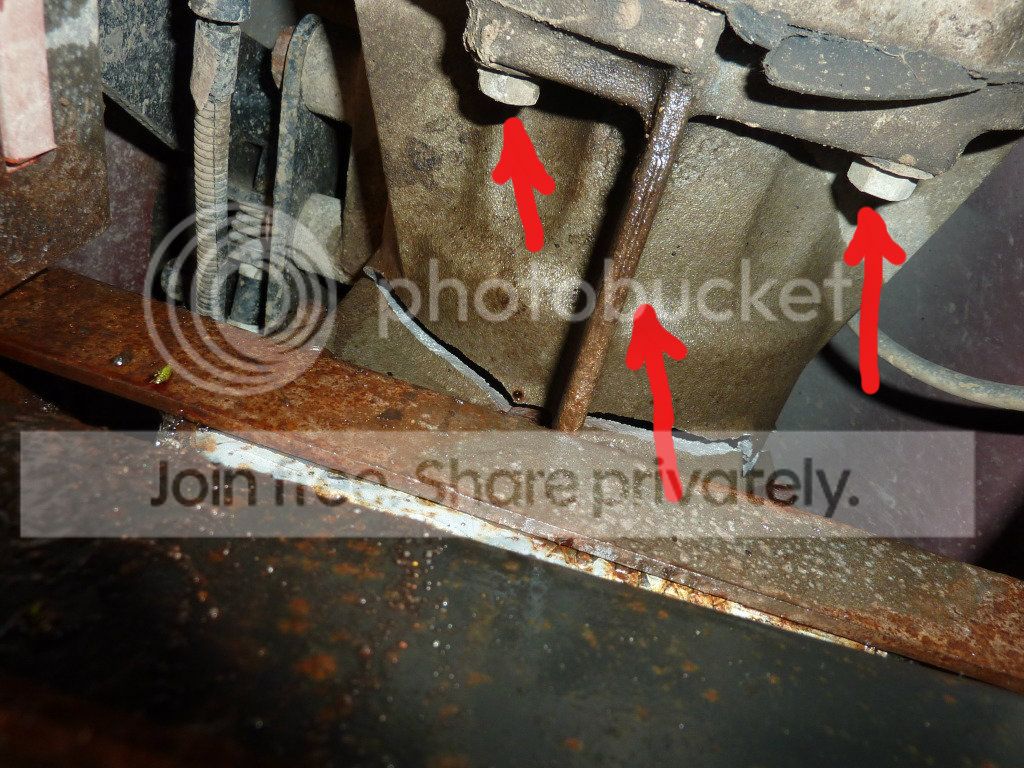

    thats definitely just that adapter housing. Compare the rib and bolt holes I drew arrows to to the second ebay listing I posted.

    If thats all that is wrong with it then im gonna be happy as hell.

    Looks that way to me. On the autos there is fluid in that adapter which would explain the leak,and that's definitely the part that is broken

    Hey sorry i havent been on in a while ive been pretty busy working 2 jobs. It turns out the crack extends into the topside of my transmission case and ive been told it cant be welded properly, so there is no cheap fix. Im getting a used tranny for $500 and i plan on installing it myself because i dont have the extra $800 for a professional mechanic to do it for me.
