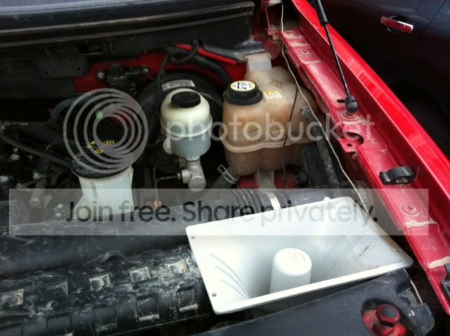

    i thought i had a better pic, but here is mine up next to the brake booster.

    Does it project sound good?

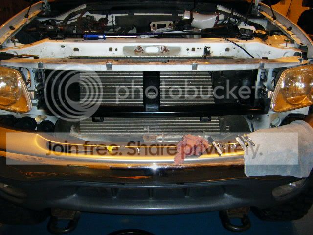

    i have a 50W speaker sitting here:

    yeah its a only a 30w tho, so not as loud as a 50w obviously, but i like up there because it wont get messed up with mud and water.
