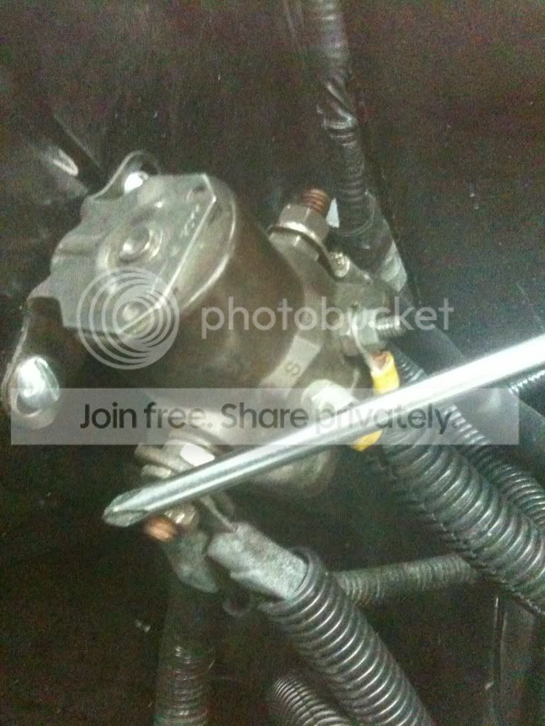

    That's 100% a faulty starter solenoid. It makes that noise when it doesn't make good contact. Or the wiring is completely faulty going I it. You could try taking a screw driver and arcing across the front two terminals On the solenoid.

    Correction!!! I just took some pics of a solenoid in the stang.( same solenoid)
    There are 4 posts on the solenoid. ( looking at the front of the of the solenoid) the one on the left goes to positive battery. The one on the right goes to the starter and the two in the middle come from the ignition switch when your cranking it. Here's a pic I just took of how to bypass the switch with a screwdriver, just place it firmly across the two posts I have in the picture ( turn the key in the truck to on position if you want it to try to start). Be careful of sparked and wear gloves!
