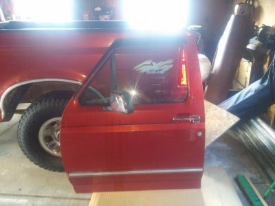

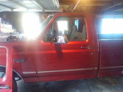

  7. Pity7700
    Hit the jackpot today. My local salvage yard had a 96 maroon (same color as mine) F150 long bed come in on Friday. Truck had the interior missing but everything else was intact.
    Got a new driver side door, new door panel for passenger side (wanted the door but it was rusted out), some trim pieces and a new set of rims and tires. tires are in good shape with a good amount of meat on them, rims should clean up nicely.
    Took me a couple hours to swap the doors. I had to swap the mirrors, one was power the other wasn't, and the lock cylinders. Took a minute to get it adjusted right too, I still need 2 new hinges.
    Junk yard run was $280 for everything.
    Engine is going back together, ordered a new EGR tube from Ford, should have it together tomorrow.
  8. Roush PSD Interceptor
    59
    That was fortunate to have another
    like yours roll into the yard for parts.
    Lots of work done, more to go, looking great Chris !

  10. str8t six
    str8t six never enough
    2,702
    19
    Back in VA
    i like those wheels you got!
