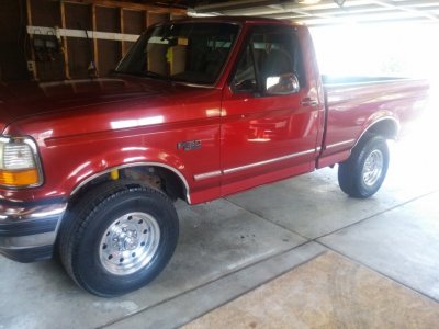

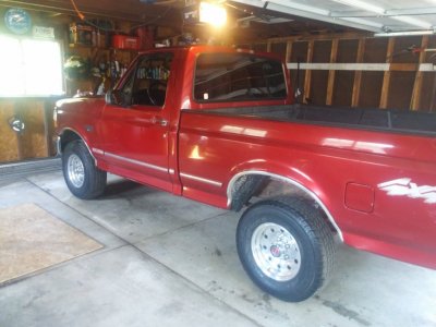

    Thanks! Couldn't believe I found em at the junk yard.

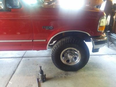

    I need to put the tires in the 3rd picture on the new rims.
