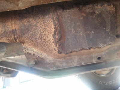

  9. Pity7700
    What do y'all think of this?
    Gutted cat?
  10. Bdons-SD
    5,905
    310
    Gutted, or a redneck patch job
