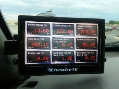

    Do you guys belive me when I say I've got a cooling problem? Lol temps are a little high now that I can see them. I think I'm gonna take off my efans and put my stock fan back in to see if it'll help me out. Anyhow, I love this thing!! Just have to get my custom tunes transfered over to this device. Anybody want an SCT handheld?

  7. iowaredneck
    Dang man you running hot. Mine runs right at 184 consistantly
    sent from area 51
  8. Pity7700
    you might have your temp control turned too high.
    my temps stay right around 200.

    Hmm... didn't think of that. I'm going to troubleshoot tomorrow if I get some free time. If If my other fan wouldnt have stopped working I could have tested the temps/fans with the tuner. If all else fails the mechanical fan goes back in :banghead:
