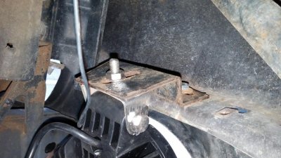

still havnt seen mount pics....maybe a link to the lights? Same ones puppyboner put behind his grill?
For you, Jarrett. The amount of creativity used to get them just right was overwhelming. Originally the brackets shown belong on the opposite side and flipped over. Because the lights are bigger than PIAA lights the bracket pushed them down farther, so by flipping them upside down it made more room for the light to sit. Switching sides allowed the bracket to be flow with the curve of the bumper better. The mounting hole was still not level but it was centered. So I Had to shove washers in between the light bracket and mounting bracket on the outside to make it sit level. Sounds confusing because it was lol pretty straight forward though, just needed a lot of adjustment.
