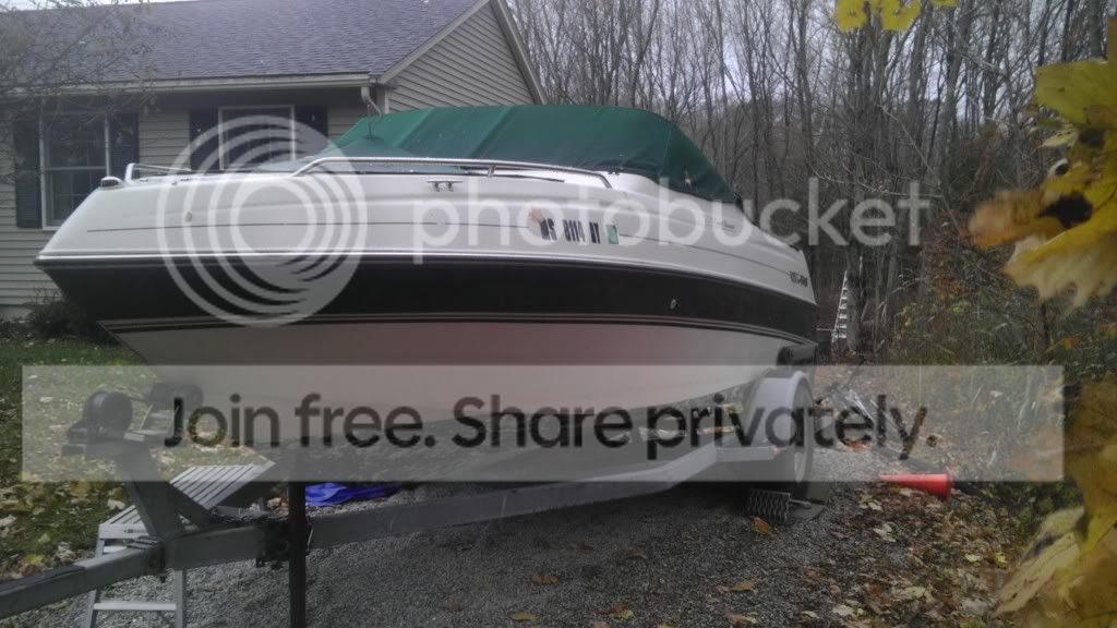

    Here is one I took this am. She needs some love.
  2. BlackThundah
    Looks like a good looking boat to me. :cheers:
  3. 01f1502wd
    looks like it could be a decent boat....just needs a little work.

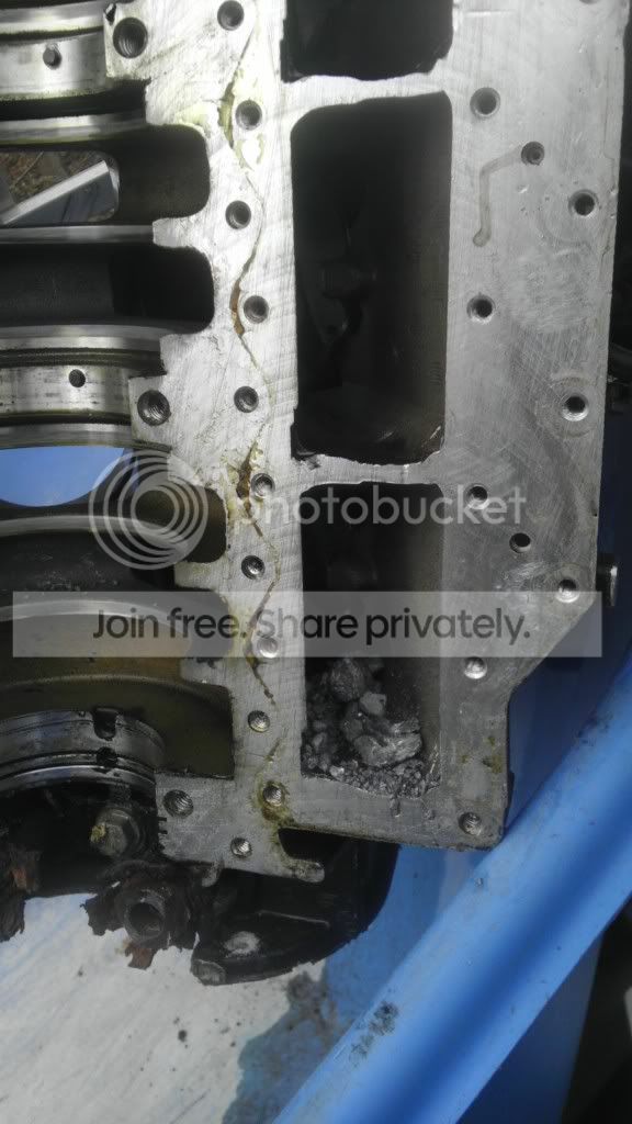

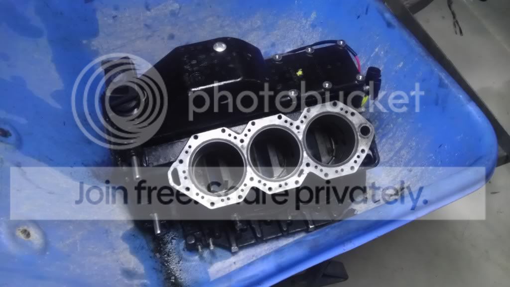

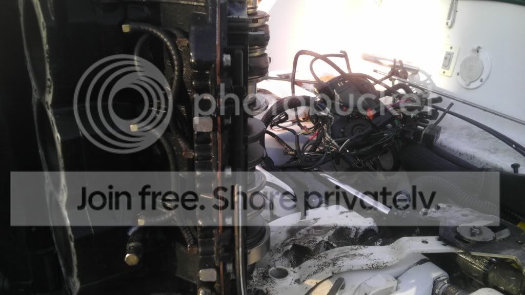

    Here's an update, I disassembled the engine. Most of it was while the engine was still on the boat. Then removed the block. There's more damage to the middle piston/cylinder than I thought. Still fixable, but more time=$$$. So, 2 pistons and connecting pins, and a complete set of rings. Used a ridge reamer and started to clean it up some. Next step is to hone/de-glaze the cylinders and determine if that will be enough to remove the damage to the cylinder walls. I may need to join a boat forum to help get this thing back together.
