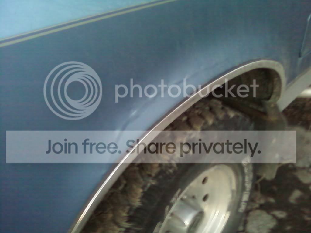

i'll try to snap a pic to show what i mean
PS rear fender

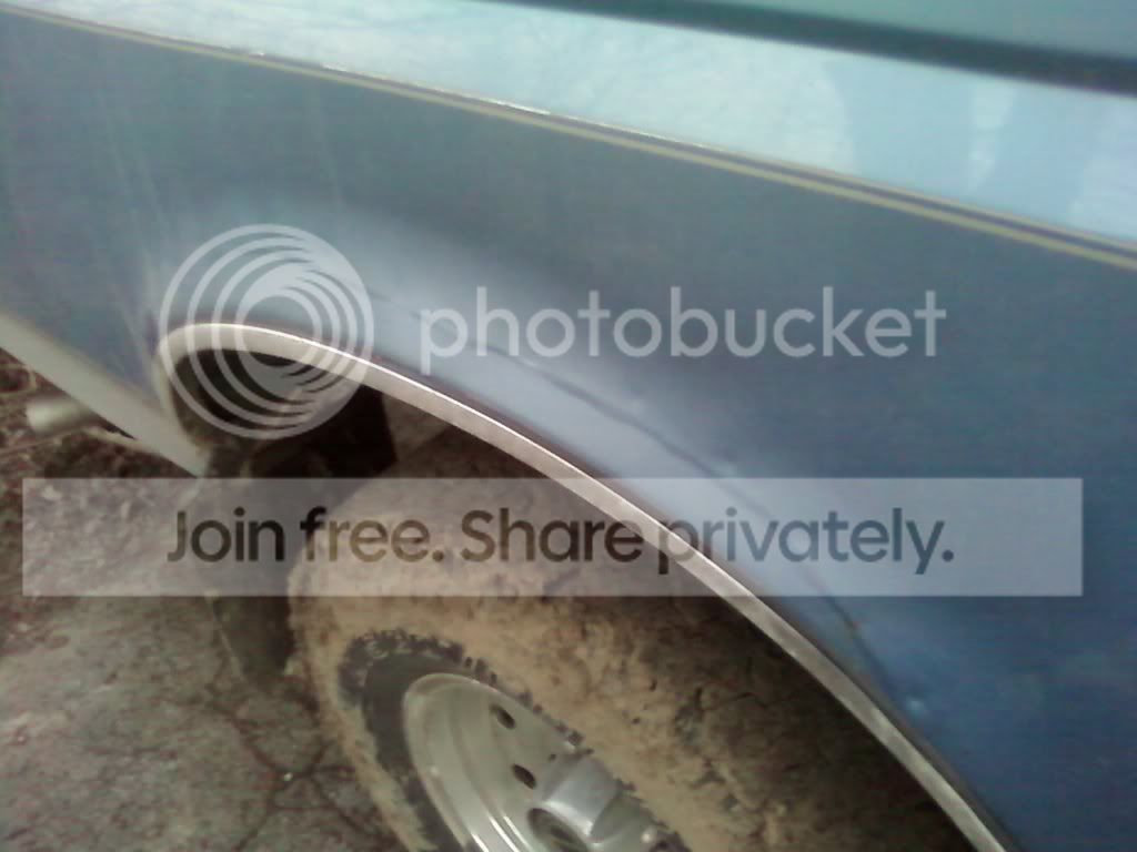

DS rear fender

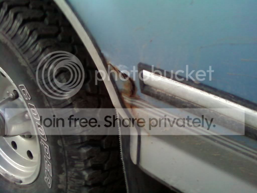

DS front fender and PS is similar

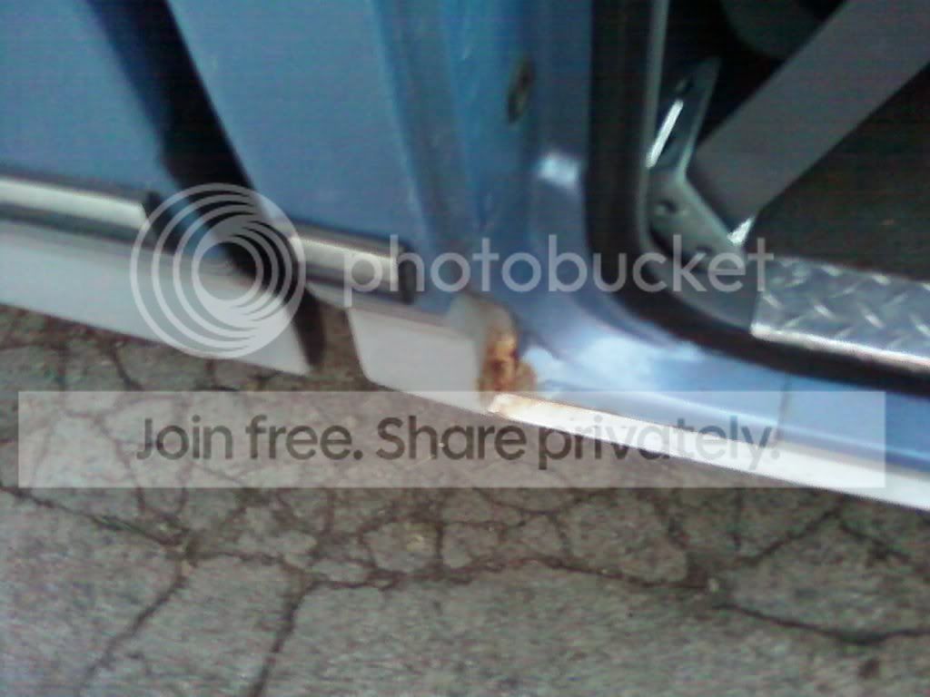

and both door jams look like this

Looks like theyre loaded with Bondo and its bubbling.
You need to get patch panels that replace the whole arch over the wheels and new cab corners.
If you just Bondo and bedliner it youre gonna get rust again.
Patch panels and fenders arent too expensive but the labor involved is fairly expensive.

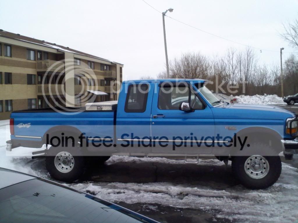

heres the idea, this is mechanicalmike's truck from f150forum, but mine will go about an 1" above the body trim and i want a cleaner line on my fenders

The radius of the fender wheel well opening you want to match can be measured from the lip of the wheel well, how wide is the roller your going to use from the bedliner application kit? Wide enough to cover the width at the top of the previous repair?
Just line the clean roller up with one edge on the lip of the wheel well, maybe with a block of narrow wood and follow it around the whole opening keeping the clean roller in contact with your guide block. Marking it every couple inches, then you can come back with a narrow tape for a clean edge following your guide marks. Apply a wider tape over that further out maybe an additional width to cover any possible spillage, mess ups.
Practice free hand bending your narrow tapeline on the marks till you get something that looks like a good radius. Sounds like it's gonna take some experimenting as to see what looks good.
