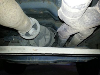

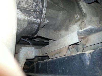

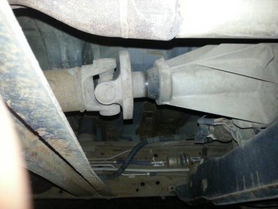

    Ok so I tried my best..
    I only have one trans mount on that one crossmember the rest is free standing. Probably not gonna help but I can try to get more if u want.
  8. Pity7700
    perfect! thanks Thomas!
    looks like you don't have any pitch at all.
    ill have to take a picture of mine tomorrow and put it up for comparison to show you what im talking about.
