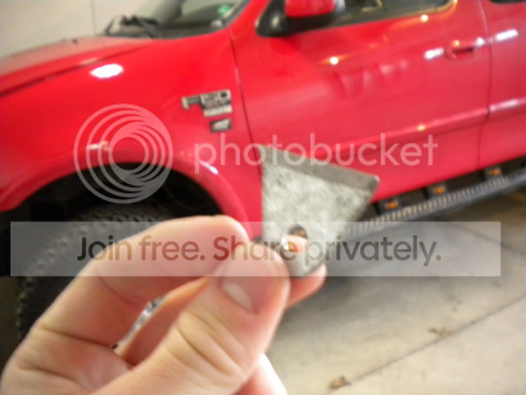

    Heres how they sit
    small metal clip with double sided tape on it.

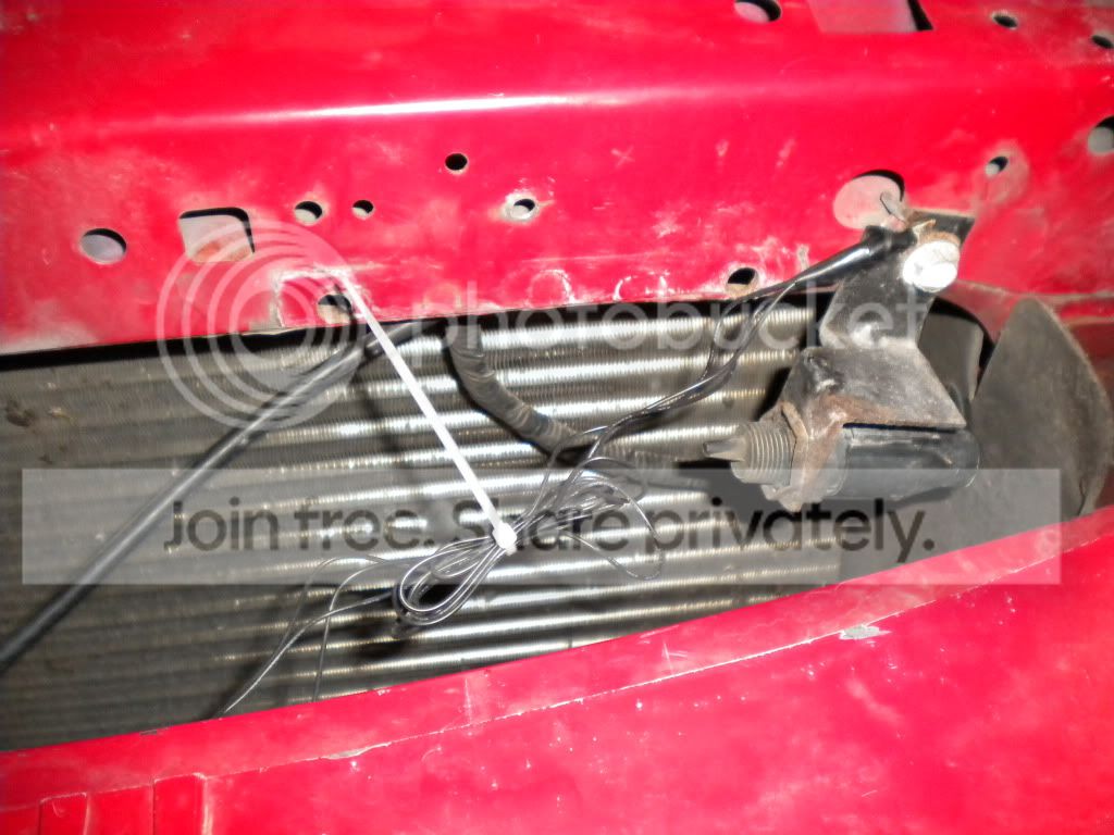

    Grounded them to the air temp sensor (i think thats what that is lol)
    Power from brown parking light wire in wire harness above radiator

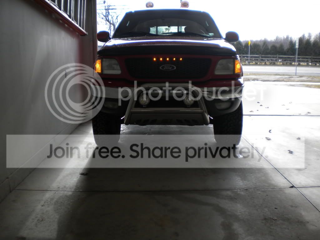

    heres what all 5 will look like. they look a little off though. i was kinda close to the truck and the two new bolts are just resting there at the moment.
    Im thinking im just going to keep them mounted the way i did it. i mean it works and they are in there nice and sturdy. plus i already have them wired up so i would have to unwire them to do a new mount.

    The way u wired those is alot better/easier than how I tried to last time ha, I never knew the wire ran that close to the grille. Nice job man.
  6. Pity7700
    Thanks dude. That loom of wires has everything that controls the outside lights in it. Blinkers, head lights, bright, fog lights ect. It was just a pain in the ass getting that loom of wires down so i could access it. its got plastic clips that plug right into the metal above the radiator, gotta pry them out. other than that its simple.

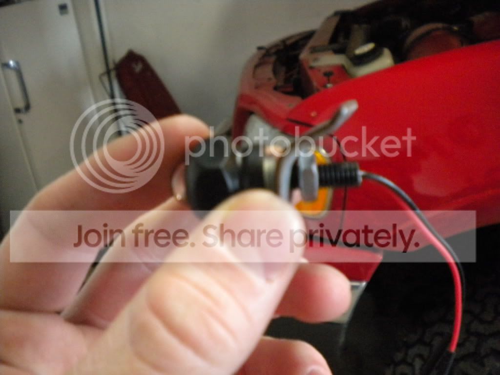

    Just put the new ones in.
    Heres what the clip looks like with the bolt in it.
    (yea i know im missing a cover on my cap lights on top lol, i forgot to put it on. lucky i didnt drive anyway)
