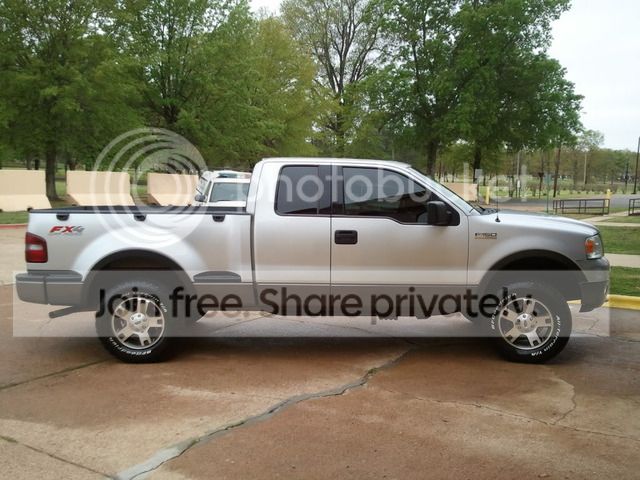

    Hello guys/gals, I have been reading here for a few days, and there is a lot of good info. I bought a loaded 04' F150 FX4 a few months ago after selling my 6.0L F250 because injectors were starting to kill me after 200k miles. I can honestly say that I love this truck. It has 92k miles on it, and I am gonna change the plugs in the very near future. It sometimes runs rough and dies when am coming to a stop, or if I load up the engine by turning the wheels all the way. I am gonna take it to my mechanic and let him get it tuned up. Do you guys have an idea of what the problem might be?
    My main question is this:
    I am gonna have to put tires on it in the next month or so, and I took it to a tire shop and spoke to a guy that most in my area consider really good. The truck looks level to me, and it measures level with a tape measure. He agreed, but he said that it doesn't have a leveling kit on it. Either way, it rides fine, and I had it aligned when I got it. I am just wondering what size tires I can fit on the way it is, with the factory 18" wheels. The sticker says it came with 275/65's, and the previous owner put 285/65's on it, but there is still some room in the fender wells. The tire man said that 295/70/18's will fit, and maybe a size bigger with a little trimming (I don't have a problem with trimming some plastic). I have looked, and all I can find are Terra/Trail Grapplers in that size. I don't have anything against those tires, but would like to know if I have more choices. What would be the next size up, and what do you guys think would fit? From the top of the tires to the fender flares is 9 1/32'' on the front, and 9'' on the back. Thanks for reading this, I look forward to doing a lot of reading, and learning a lot from this sight.

    i call bull sh!t that truck has to have some sort of leveling kit. put a 35 toyo mt on that thing

    Thanks for the reply. I kind of feel the same way myself. I have never seen one come level from the factory, but that is what he was implying.
    Can I go with a 33/35x12.50 with the stock wheels? I am not sure how wide they are, or if they would rub the upper control arm on the back side.

    :cheers: and welcome to the site. You should be able to fit a 35" tire under there no problem. It just depends on the look you want. I personally would go with the 35's. That would be like a 315/70/18 (or there abouts depending on the tire) AT's are going to run a touch smaller than the MT's.
    That truck sure looks like it's got a level kit on it. :hmm:

    Definitely has a leveling kit. If its not a Spacer kit, then its a full shock replacement, like a Rancho Quicklift or Bilstein 5100. No one is that truck level from the factory. the front is up.
    305/70/18 = 34.8" tire. This is a real nice width, lots of sidewall for curbchecks (less rim damage) and you should be able to find plenty of more tires/brands in that size range.
    i think that a 12.5" tire might be just a bit too much width w/out a lift kit, but let the 4wd guys tell you for sure. I know when I put the 35/12.5 on my truck, the inner tire wall was too close to my UCA. I couldnt even slip my pinky between there at natural ride height, didnt want to see what happened at full suspension so i added spacers.

    First Off welcome to the site! You will enjoy it here at FFS! very nice truck and yea I call bs on that guy telling you your truck dont have a leveling kit. When it comes to tires it is comes to personal preference. Are you wanting an m/t or a/t? I'm looking at getting the nitto trail grappler m/t.

    Thank you sir. I know it has some kind of leveling kit, but like I said earlier, it rides good, so I'm not gonna beat myself up trying to figure it out. I think I am gonna find a different "tire guy" though. Thanks for all of the fast replies.
