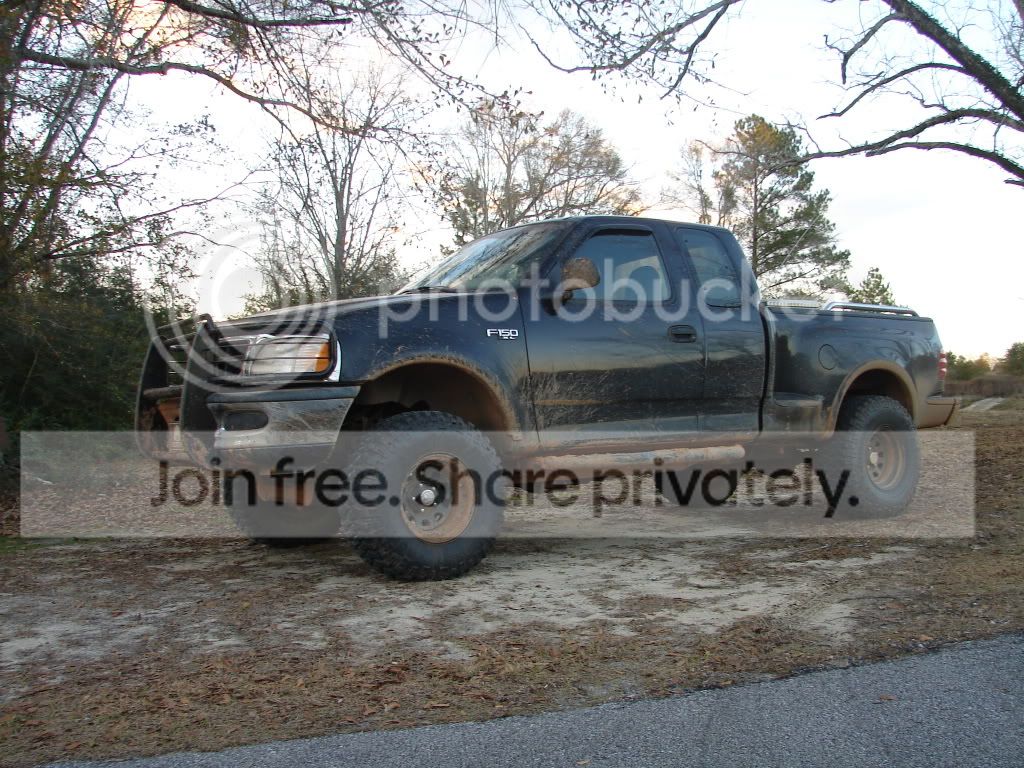

offset rims would do you a lot of good. i got mine for 94 bucks a piece my truck with the same exact lift and tire size setup but with offsets
Damn, is that with Tbar cranked all the way up and trimming? I just bought these last month so itll be a while until i need new tires. Also, i have considered some new rims. What offset would do me justice? I dont really know much about wheels. Mine rub at full lock and it is really starting to irritate me. Im to the point where i would buy rims before i buy spacers. Fuel Hostages or something along those lines. Right now im trying to tune her up and get her running great, some of the 100k maintenance is behind lol
Black fuel hostages 17x9" with -12 offset and you'll have a nice wide stance. Or the same size rims, but fuel octanes would look really good too. They're also probably easier to clean as well
yea that was cranked bars (which isnt saying much because mine are old and saggy haha) and a 3 inch body and all i had to trim was a small bit of corner off the plastic valence and it only scrubbed when i was flexing and turning do a -12 offset with a 4.25 backspacing
