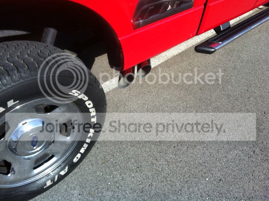

    I’ve been wanting to upgrade my exhaust ever since I bought my truck and finally got around to doing so this weekend. I like doing things myself, but have limited tools so the entire system installed with a reciprocating saw and some hand tools. Additionally, all of the parts were purchased from major auto parts stores (primarily O’Reilly). Here is a breakdown of the parts used:
    Muffler – Magnaflow single 2.5” in/dual 2.25” out. Model #12258. This actually came from Amazon. I originally wanted the dual 2.5” out, but found this one from Amazon Warehouse deals in like new condition for 60 bucks. Couldn’t pass up the deal.
    Tips – 2.25” in/3.5” outx18”L slash cut
    Other parts:
    2.5”x18” extension (used between factory pipe and muffler inlet)
    2.25” 45* elbows (connected directly to muffler outlets)
    2.25”x24” extension (used between elbows and tips)
    Universal hanger
    Clamps (2x2.5”/6x2.25”)
    And a couple of pics...

    Not to shabby man. I did the same on my 03 except I used a flowmaster and I welded everything. Looks good

    super flush, good job sir

    looks great. i hope to have a side exit exhaust on my truck soon swell.

    That looks great. We need to hear it now :peace:
  10. VanoFord
    very nice job. very symmetrical between the two tips so all your measurements truly paid off. :waytogo:
