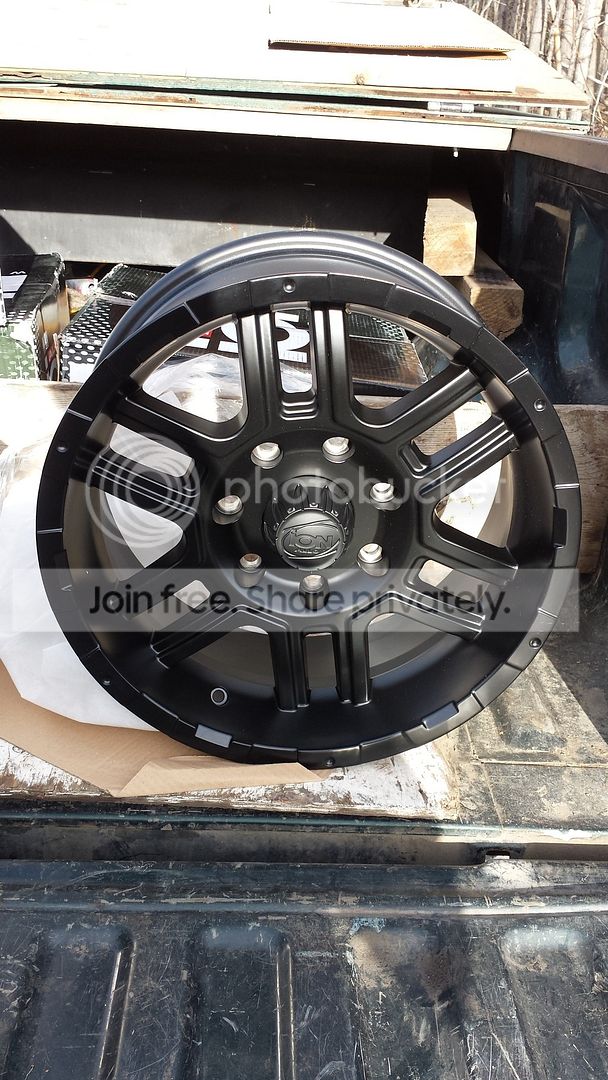

    Good choice. Looking forward to seeing the pics. The Ion Alloy's are my second option. Been thinking of getting the XDs- 4wo|XD rims. They look cool though a bit common so I can't decide yet.

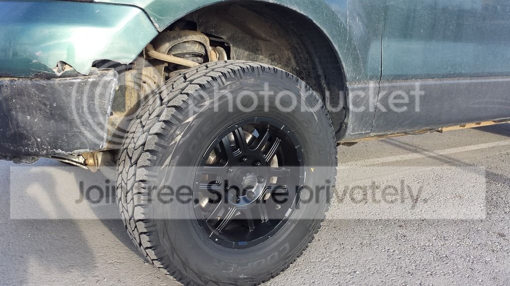

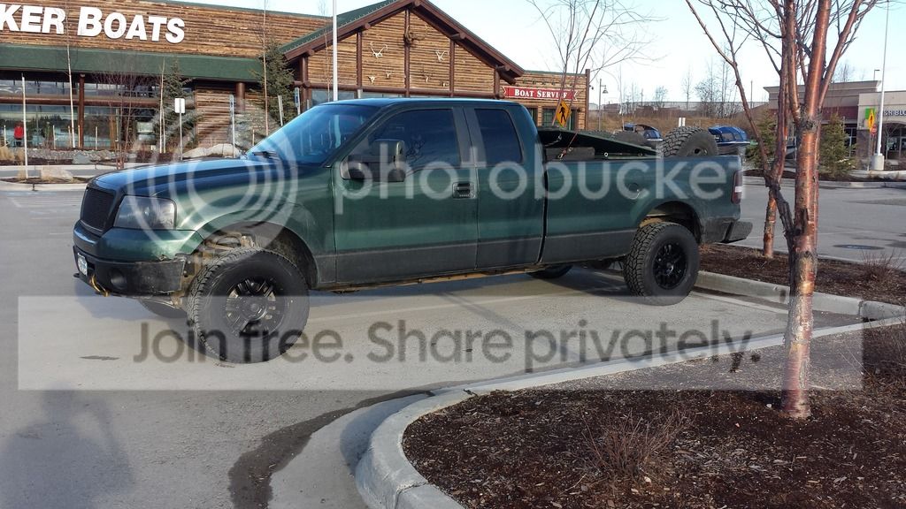

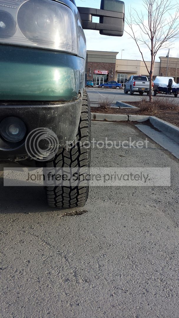

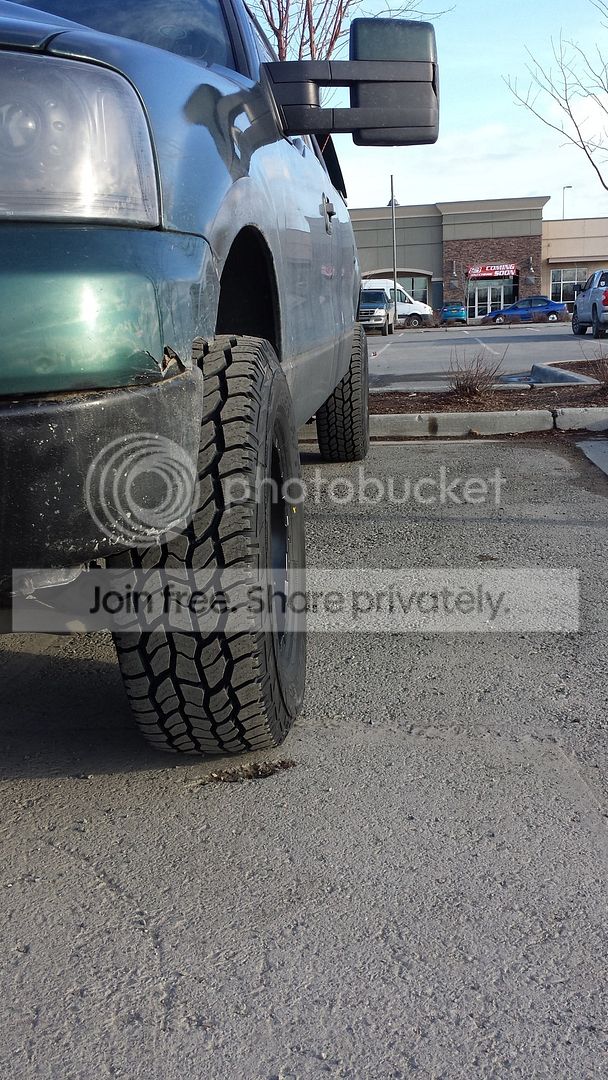

  2. ak_cowboy

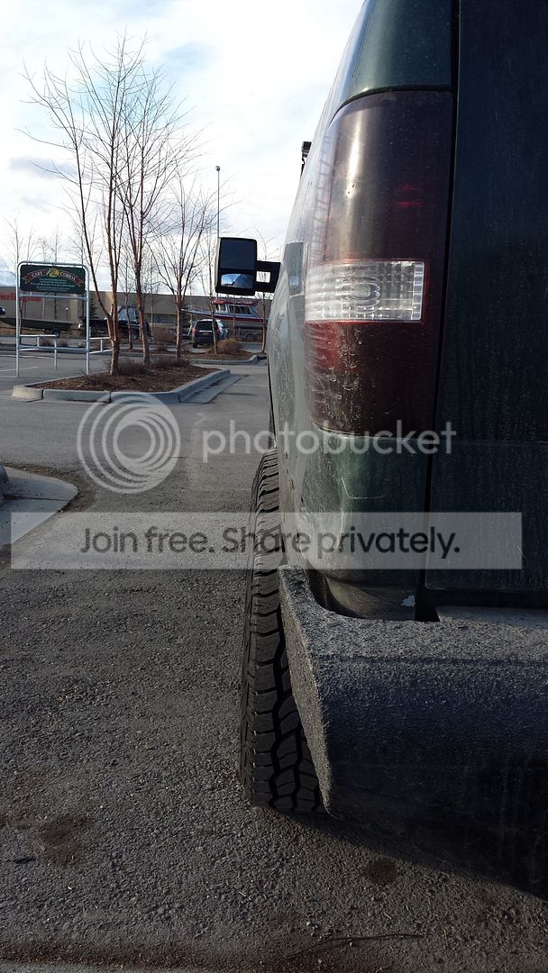

    Got them installed with Cooper Discoverer AT3s
    [​IMG][/URL[​IMG]

    Turned out great!!

    I put those on the Liberty before we got rid of it. Drove to Utah with them in rain, ice, and snow. I was impressed. I would get them again.
    Truck looks awesome! Wheels look great!

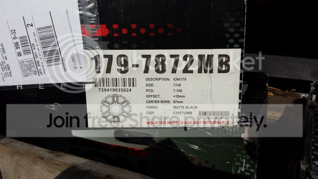

    man, a +10 is a pretty aggressive wheel and that tire is a 34.4in tall tire and 12.2wide as well. thats gonna be a tight squeeze, you may have to trim the **** out of it

    i saw that there were pics of it after i posted that. is that the same size tire you said you were wanting to run ?
  8. ak_cowboy
    Thanks guys! Tires are pretty decent for an all terrain. No complaints yet.
    Tires are only 32.7×11.2 and I've got a 2" level all the way around. Tons of clearance.
    I want to run 35s, but these were on sale and are the same size as my winters. I'll need fender flares to run any wider of a tire also.

    3
    I'm a sucker for black wheels on dark green trucks. I used to have a Forest Green Cherokee with black Pro Comp wheels on it. Looking good dude.
