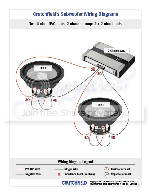

    Good to hear.
    Use those pics from Crutchfield to wire it up this time! :jester:

    Well this is how I have em wired.. Now that I know one sub wasnt working the whole time Im gonna fix it and run both subs.. So which diagram do you suggest I use??
