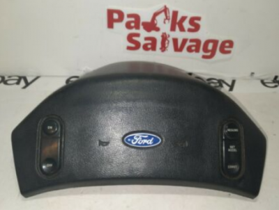

Also, anyone know where I might be able to find the buttons for the cruise control? They are missing. I know they are part of a small harness, which I have no problem getting the whole harness, just wondering if there is somewhere specific I should be looking.
