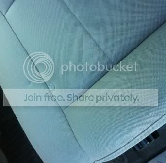

    The guy I purchased my truck from was a smoker and really wreaked havoc on the driver’s seat. There were multiple cigarette burn holes with one of them being quite large (about the size of a dime and pretty deep). I really want some Wet Okole, but don’t want to pony up the cash right now. So, this weekend I decided to try to patch them. Here’s what I did….
    1. Cleaned the wound
    2. Shredded some seat cushion foam to fill the odd shape of the cavity. I filled it almost level with the top of the seat. I added some super glue as I was putting the foam in the hole to keep it in place.
    3. I cut a small piece of seat fabric from the underside of the middle jumper seat.
    4. I trimmed this into a ‘plug’ that fit the burn hole.
    5. Once I had it cut to size, I super glued the ‘plug’ into place.
    6. I also added a small ring of glue around the edge to prevent fraying. This doesn’t look the best and could probably be achieved another way such as sewing, but it’s not too bad.
    I think it turned out OK, definitely looks better than the gapping cigarette burn!
    I also patched a smaller hole using a similar method, just without the additional foam padding. There were a couple other tiny holes that I mended with a couple of stitches.
    Before:
    After:
  2. iowaredneck
    looks better than before, nice job
  3. cowboy
    good thinking on where to pull fabric from
  4. LightDuty
    LightDuty Full Access Member
    3,370
    Michigan
    Turned out pretty good. much better than having that hole there.
  5. Bdons-SD
    38
    5,905
    311
    Looks good, clever.
  6. Bee89
    Bee89 Super Moderator
    3,306
    Aug 17, 2011
    Miami, Florida
    great fix, looks much better.
  7. supercrewzn
    7,871
    Trucks did something similar. They used a fabric glue tho. He took a razor blade and scraped some fabric off the of seat, then took that and the glue and put it in the hole. You couldn't see where he made the patch.
  8. ak_cowboy
    Nice fix :peace:
  9. KingRanchDiesel
    1,026
    Jun 16, 2011
    Mobile, AL
    thats pretty awesome! had to get up close to the screen to see where the hole was :jester:
