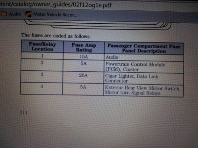

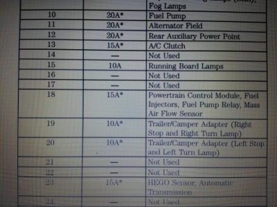

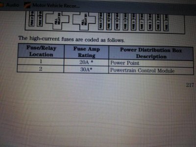

    Or this #2 relay under the hood?
    Or this #18 under the hood?
