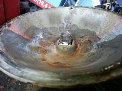

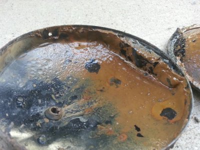

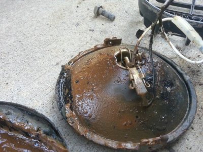

    First thing I saw was mud, dirt, water, rust, and nastiness everywhere.
    Old light bulbs looked like this so I used my buddys discount at oreillys and got new ones for half price.

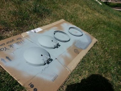

    Basically just had to pull apart the lenses and stuff and cleaned them all up really good with wire brush and sandpaper. Then to make them look decent I hit it with primer and black gloss paint. uploadfromtaptalk1374282385306.jpg

    The water had started eating away the chrome reflector on the back of the housing so I went ahead and took it off. Its sort of a ceramic bowl in the way it feels. uploadfromtaptalk1374282513371.jpg

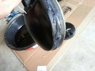

    Used a shat ton of silicone because the lights are under my truck and the only part you can see is the front. So yeah, they look terrible on the back but they work now, and hopefully won't leak anymore.:D uploadfromtaptalk1374282663941.jpg
