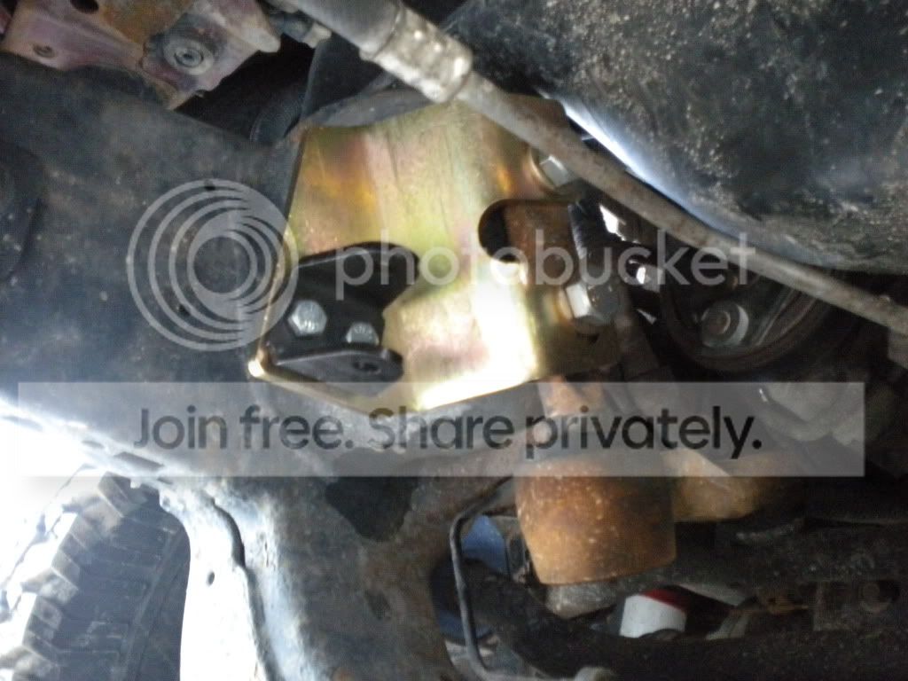

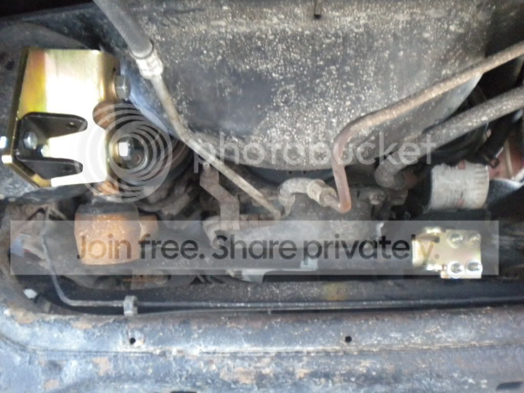

    the big bracket in the kit goes right over top of the idler arm bracket. you have to take the idler arm bracket bolts out, put the stabilizer bracket on top and put new bolts that they provide in the kit (24mm bolts) through the stabilizer bracket and the idler arm. torque to 160 ft/lbs.

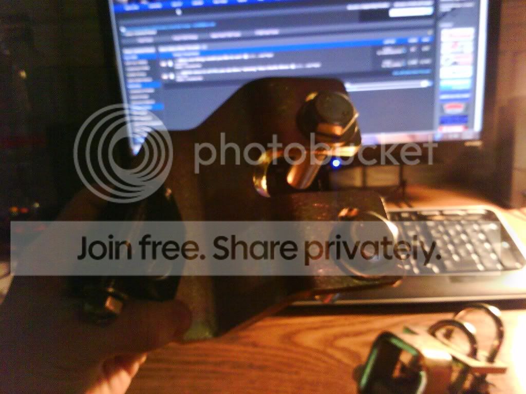

    heres the bracket
    here it is installed

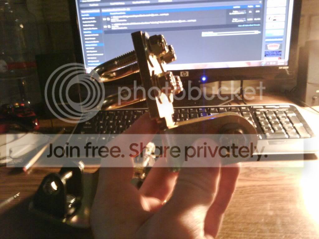

    the kit also gives you a small black bracket to install on this bracket.

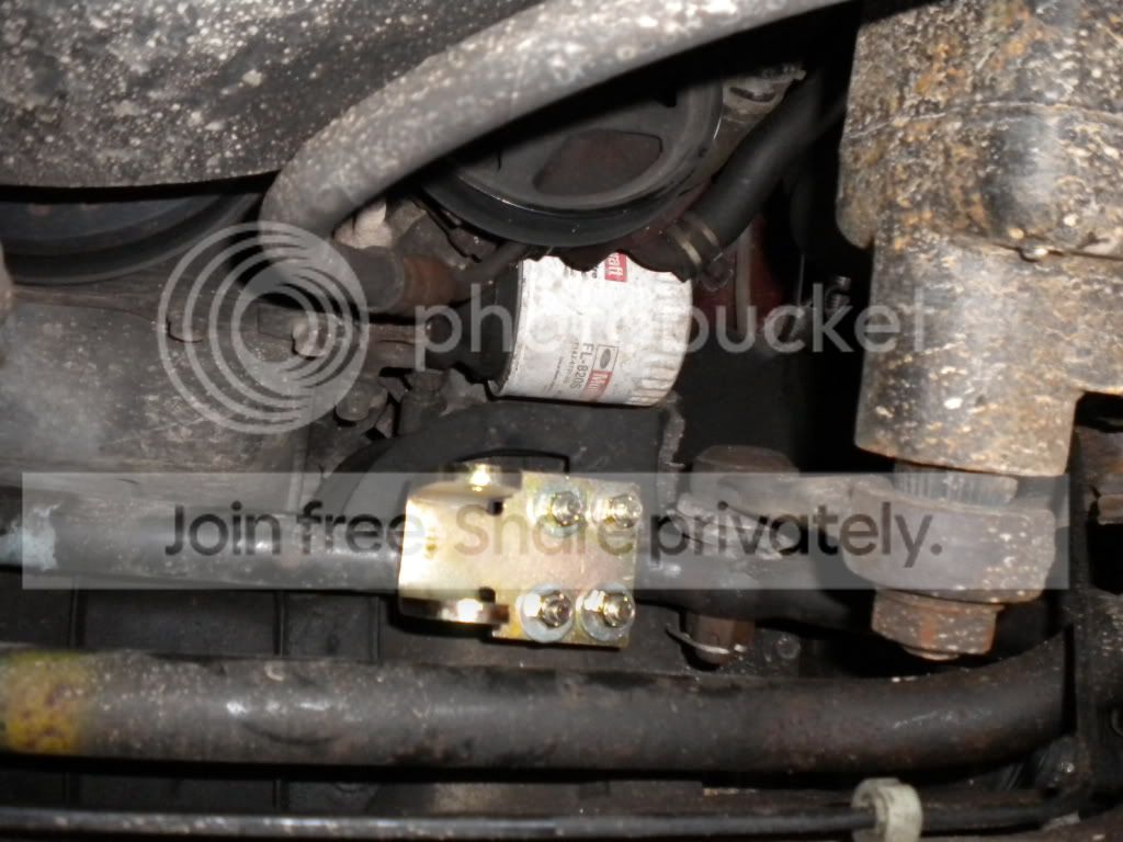

    this bracket that has the two U-bolts on it mounts on the center link/drag link.
    installed on the center link

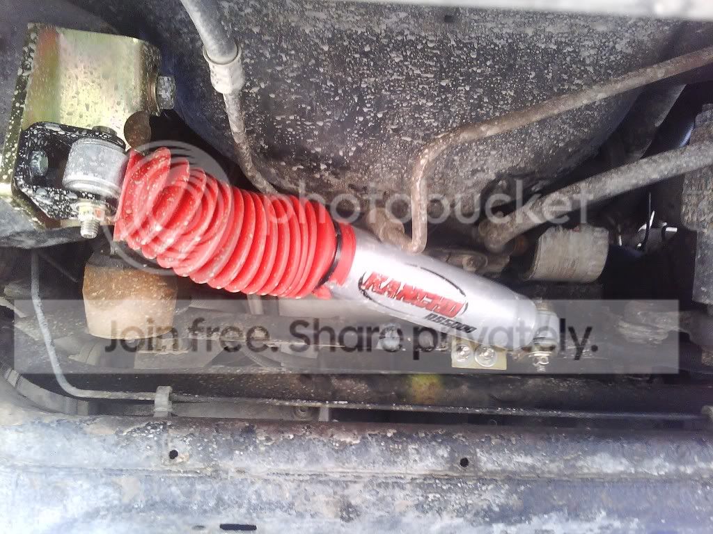

    got it installed.
    i took the truck off-road real quick on a trail to see if the wheel jumped and if there was any difference in steering. steering feels smoother over bumps and the wheel didnt jump. i will post up in the next few days after i get to do some driving around on it. i have to take a look at the bracket on the right of the picture tomorrow, i believe it has to be flipped the opposite way.

  7. Pity7700
    lol i just edited my post. the bracket can hardly be seen in the picture. i have it mounted right but i think i have to take the bracket off and turn it so the stabilizer mount is on the outside and the U-bolts are on the inside. i agree, they show how to do the other bracket but not this one lol
