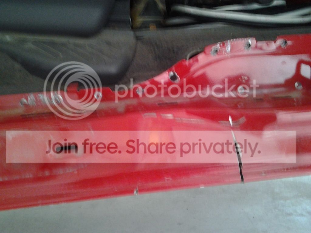

    did some more on the rocker removal today. sorry for the blurry pictures. i blame it on the fact that im sick!

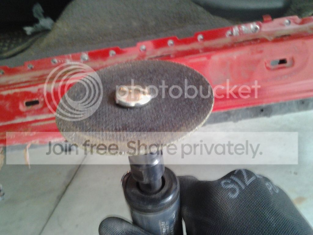

    went and got me a little 3" cutting wheel for the die grinder. worked pretty good. my air compressor is too damn small though.

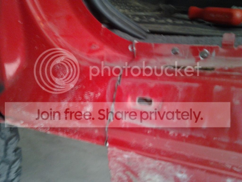

    made a couple cuts

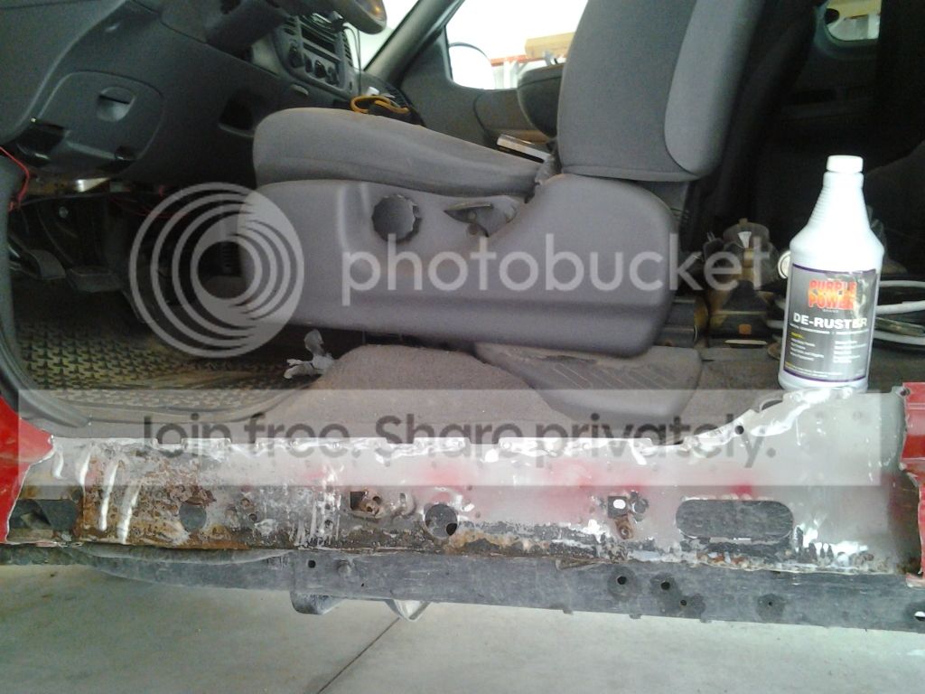

    treated the rocker with some de-ruster, i love that stuff. letting it dry and tomorrow if i get a chance im going to spray the **** out of the rocker with some undercoating. just bought some permatex heavy-duty.

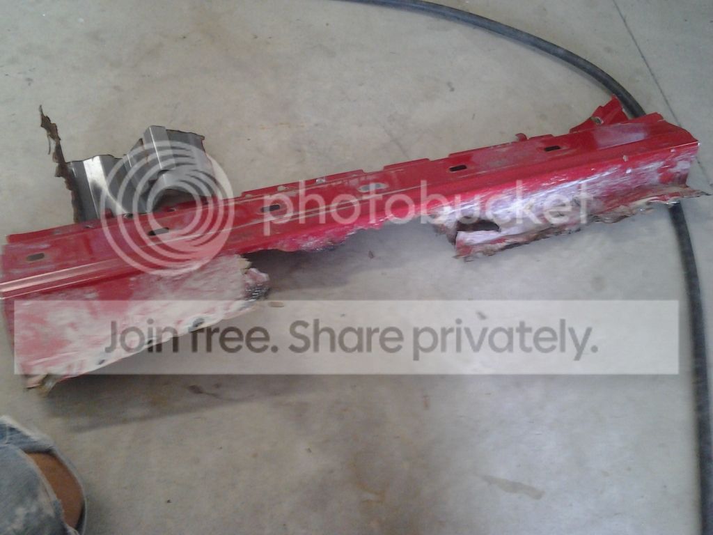

    heres what came off
    ive gotta cut a little more off at the back but i was afraid if i cut more off that the back door would wobble while driving since the door latch is on the rocker panel. the new panel is on its way from FIXMYRUST.COM. they are located in Ohio, hopefully it will be here by this weekend.:peace:
