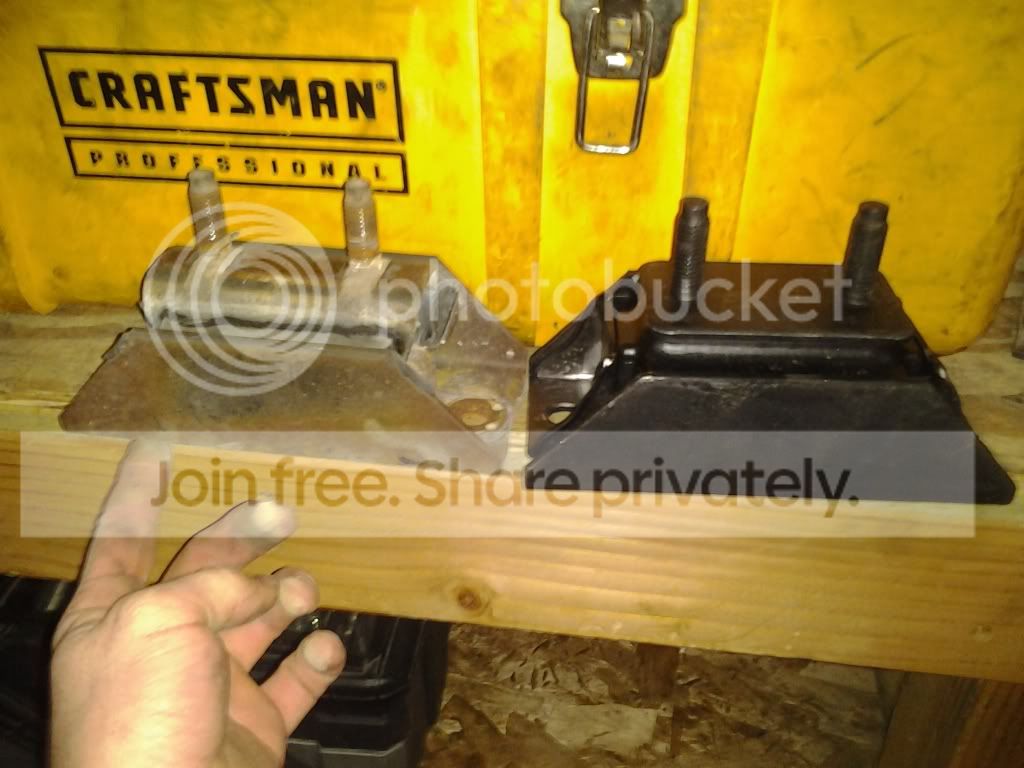

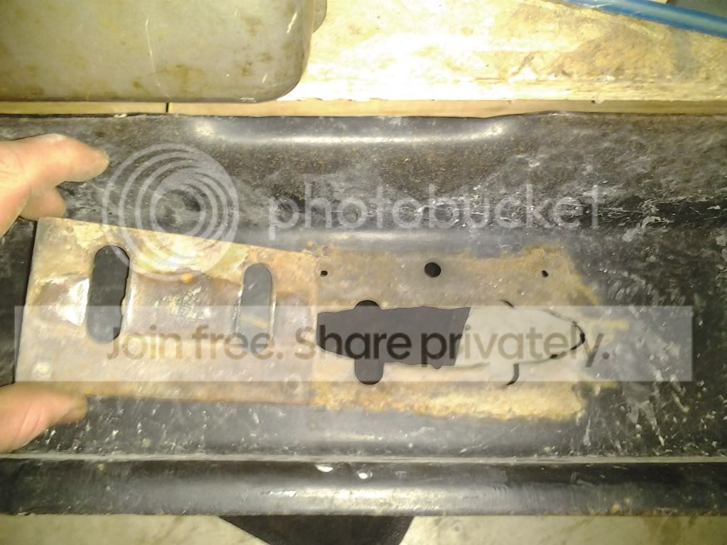

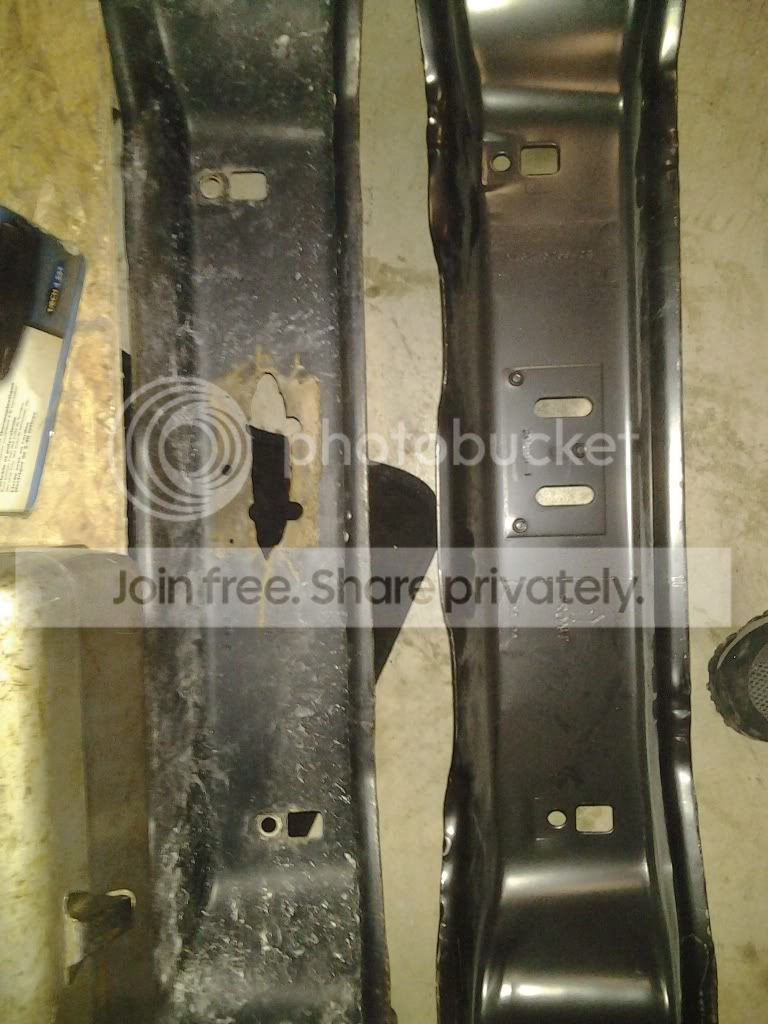

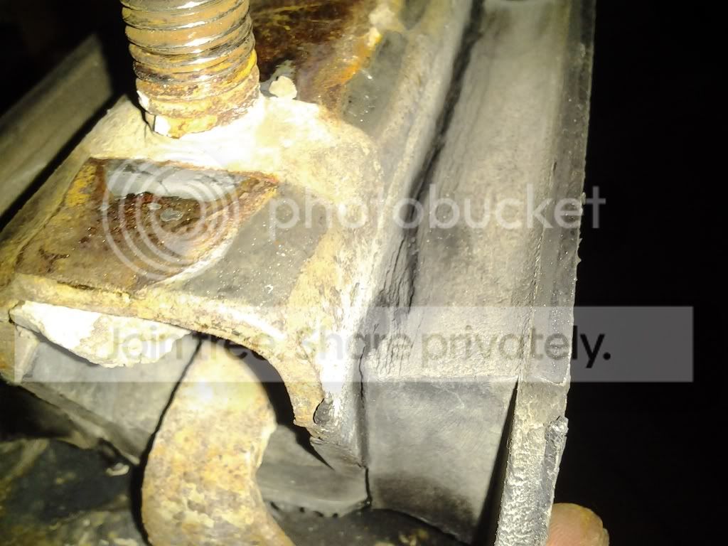

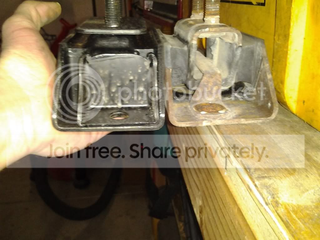

  3. Pity7700
    alright got one problem taken care of.
    the trans support was so bad that it broke apart when i unbolted it.
    i also had to buy a new transmission mount where the support bolts too. the thing looked pretty bad and was falling apart.
    rubber was broken in half
    the new one looks stronger.
    trans feels much better. no slamming while braking. before i could push up on the drive shaft and the transfercase and trans would all move up and down quite a bit. just drop it and it feel much better.
