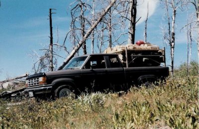

    I hear ya on the no 4wd on the pickup Brendon! I had a 59 Apache Fleetside when I moved to Wyoming in '83' had nothing but 4x4's since winter of 84/85. Yes... I really do have a clue how to drive in winter conditions.
    Gonna give that ls a good test next week. Got 5 cords of wood to cut and some of the trees are up a dang steep hill :) No kidding... so looking forward to taking my truck and doing with it one of the many things it was made to do!!! If you could ask my old Ranger what he did for me.
    Lol... I'd had my brand new 90 Sandlewood brown Ranger xlt for one week... elk hunting season started and I sat on the bank of the Marsh creek fjord -- that really did eat a ¾ ton later that day -- and boldly stated: "is it a Ford or not" Always did treat that truck like it was a real one and it absolutely never disappointed... from new 360,000 faithful miles. And I put every one but 40 on it :)
