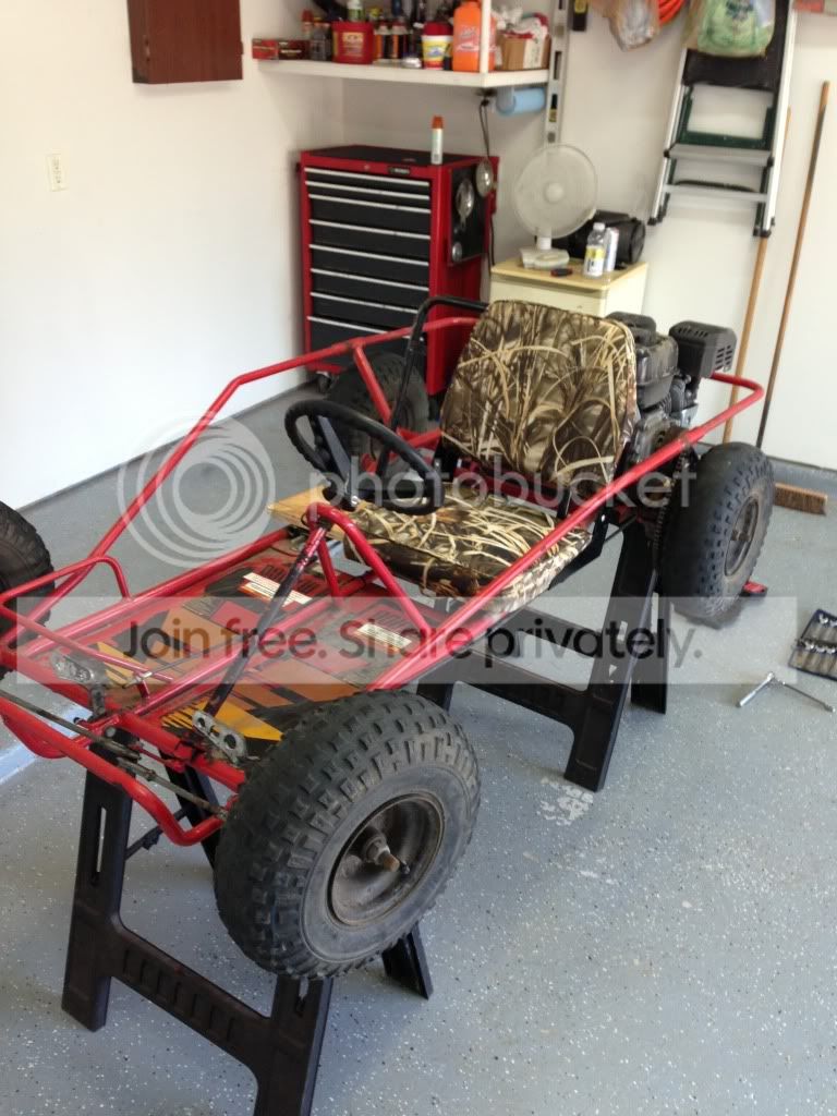

    Yeah my backs all bruised up from 2 hours of riding offroad.. We wana try to put some kind of suspension on it. There's an atv/gocart junkyard north of Houston I'm gonna go to

    Hinge the rear frame of the cart, from the seat back.
    Then put a couple used coil over shocks mounted horizontal
    front to back like a F-1 car.
  6. TxFx04
    We wana hinge the rear kind of like a swing arm on a dirt bike.
    Got the seat mounted up. 1046x better than an old road sign
  7. VanoFord
    43
    I'm not sure how a swing arm will work being that the belt/chain would have to be able to expand to allow the bounce or else the engine needs to move w/ the entire assembly. But then again I don't know go karts that well.
  8. BlackThundah
    He should be fine. The way that chains setup shouldn't be a problem if you cut the frame in front of the motor.
  9. TxFx04
    Yeah we'd have to move the axle back since the sprocket is directly on top of the drive gear. It'd be alot of work. Idk if we'll go that route
  10. Roush PSD Interceptor
    58
    How about springs under the seat like on a riding lawn mower?
    Another rear option would be live axle.
    I know ya don't want to spend for an IRS.
    The way my son's Stingray go cart is set up the 6.5hp motor is set
    in front of the gear sprocket. IDK why it wouldn't work
    if the clutch is rear of the wheel gear sprocket.
