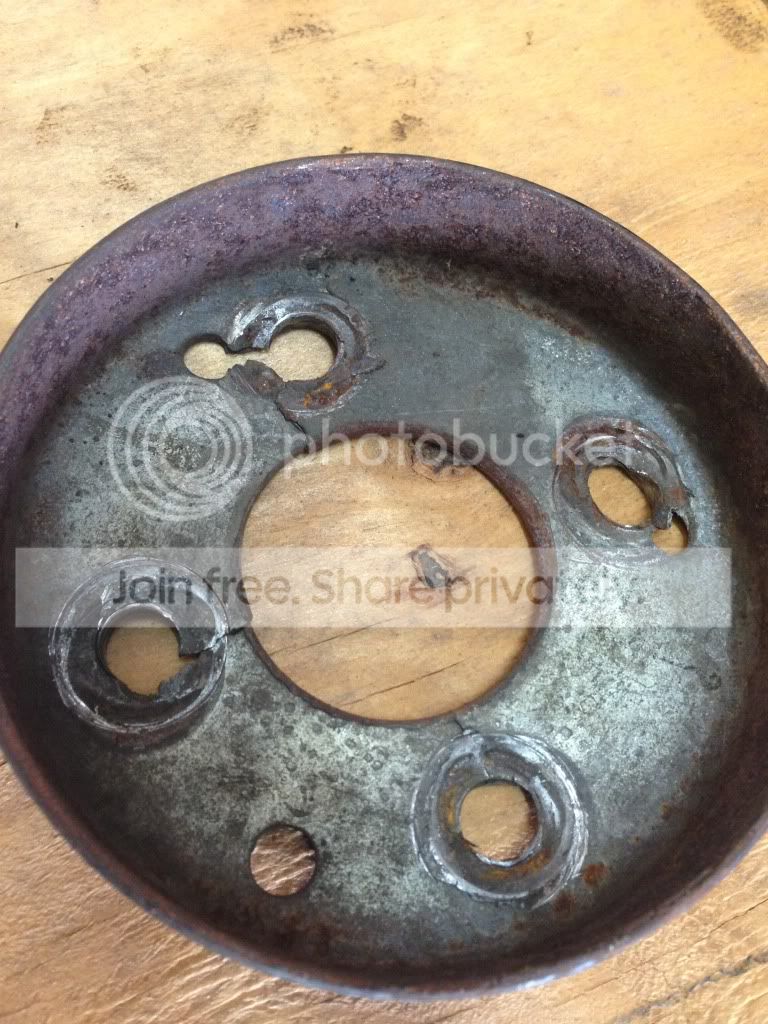

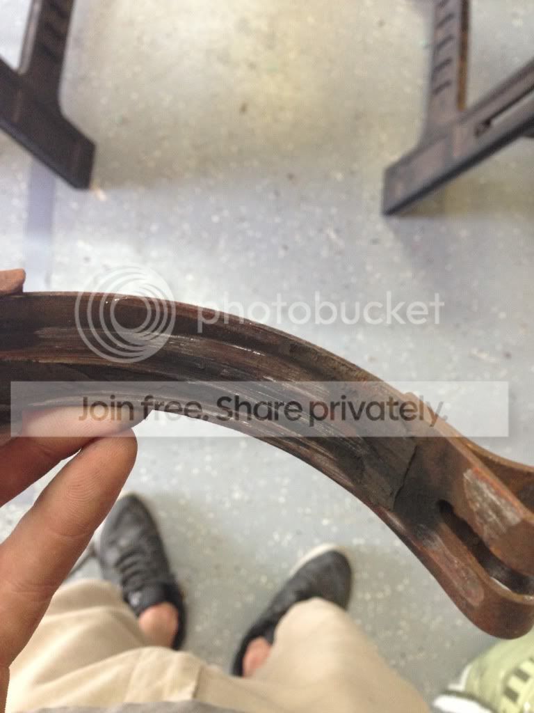

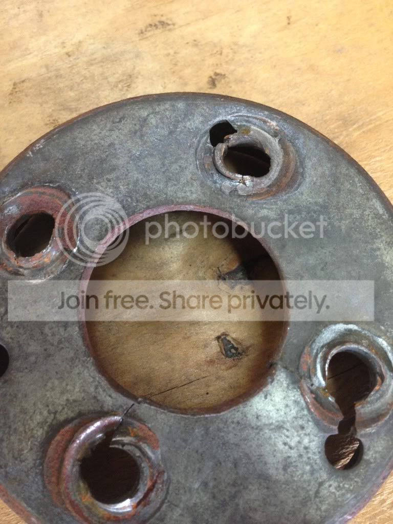

    UPDATES. haven't worked on this bad b*tch for a week but here's what got done. Swapped the brake rotor out, old rotor was cracked around every bolt hole like they tried to jump it or something. replaced the brake pad too, old one was down to bare metal. got a half chain link from the go cart store and put that in. we still can't get the chain right. it's on there but it's still so loose. test drove it 3 times and the chain popped off. finally got it to where it would stay on at high speeds but it's still pretty loose. we've tried everything. we also rigged up a kill switch so we don't have to reach behind the seat to turn the motor off it's right there on the steering wheel.

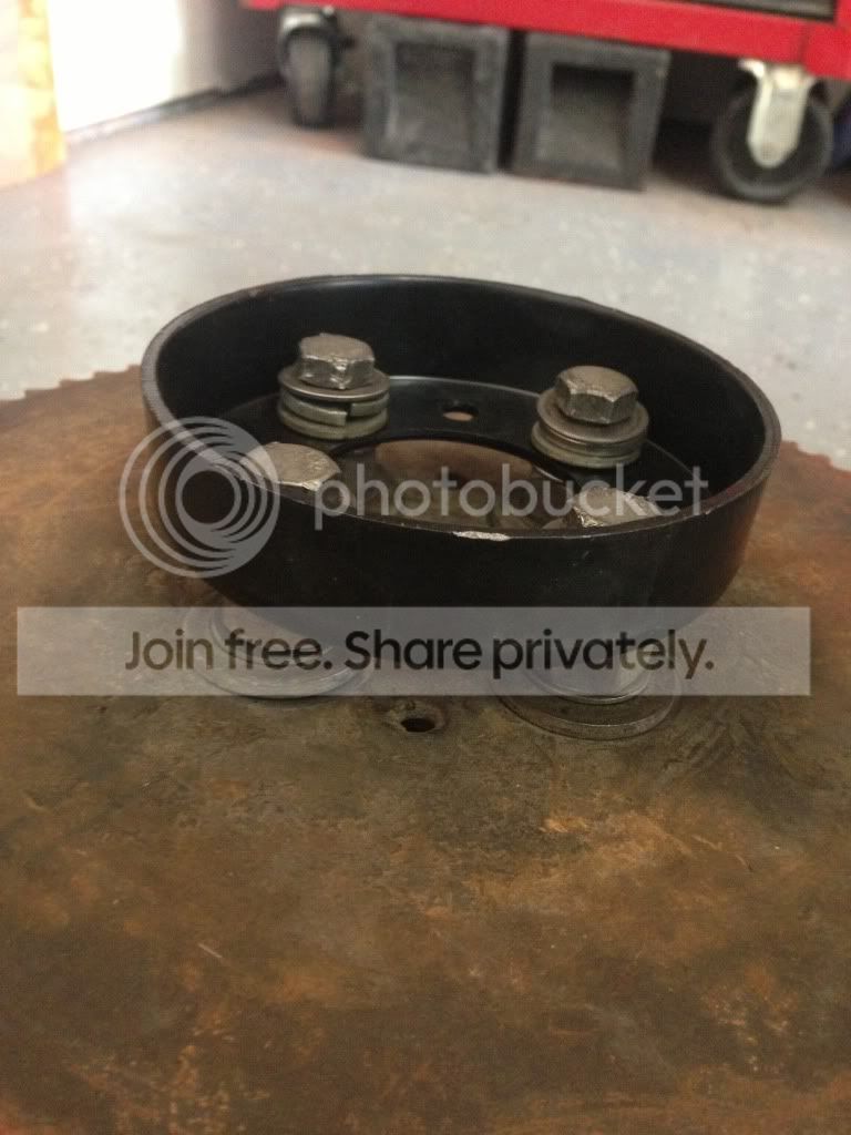

    new rotor, please excuse the mess of bolts and washers. that's how we got it lol. it's the only way it lines up with the drive sprocket on the motor haha
    old rotor with cracks.

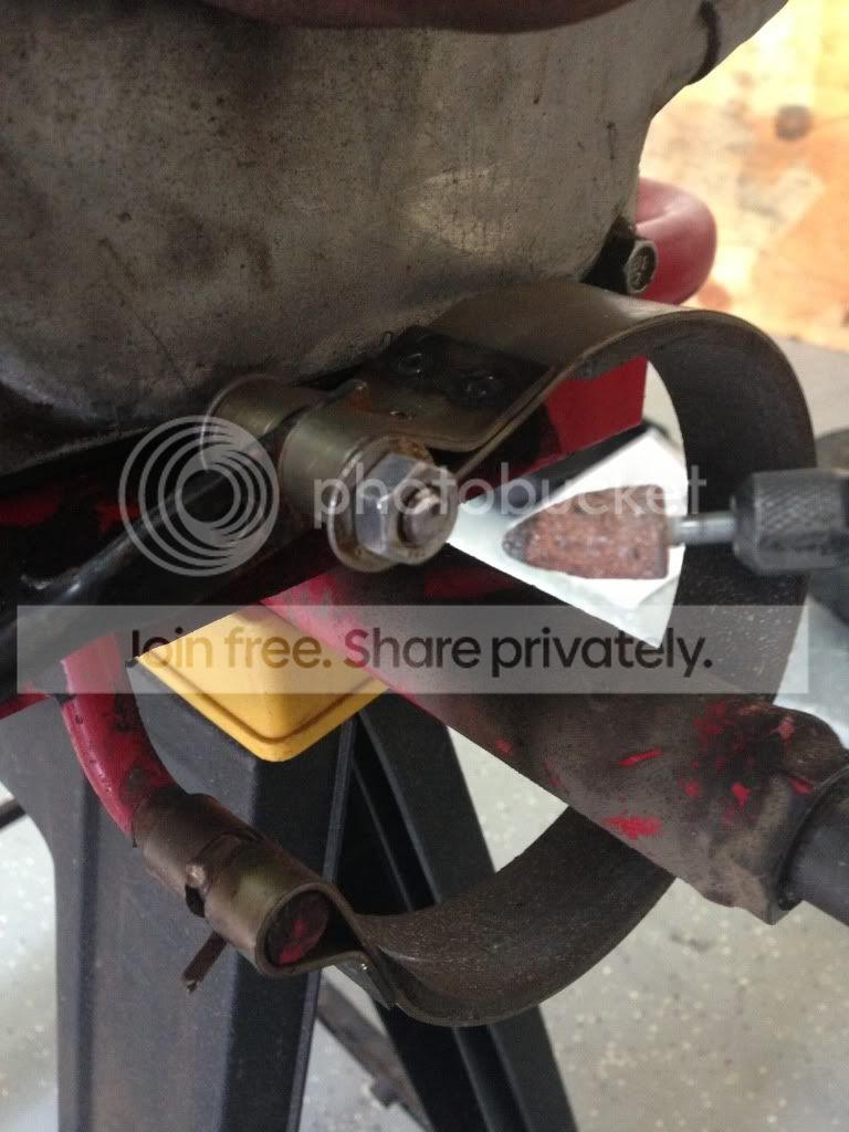

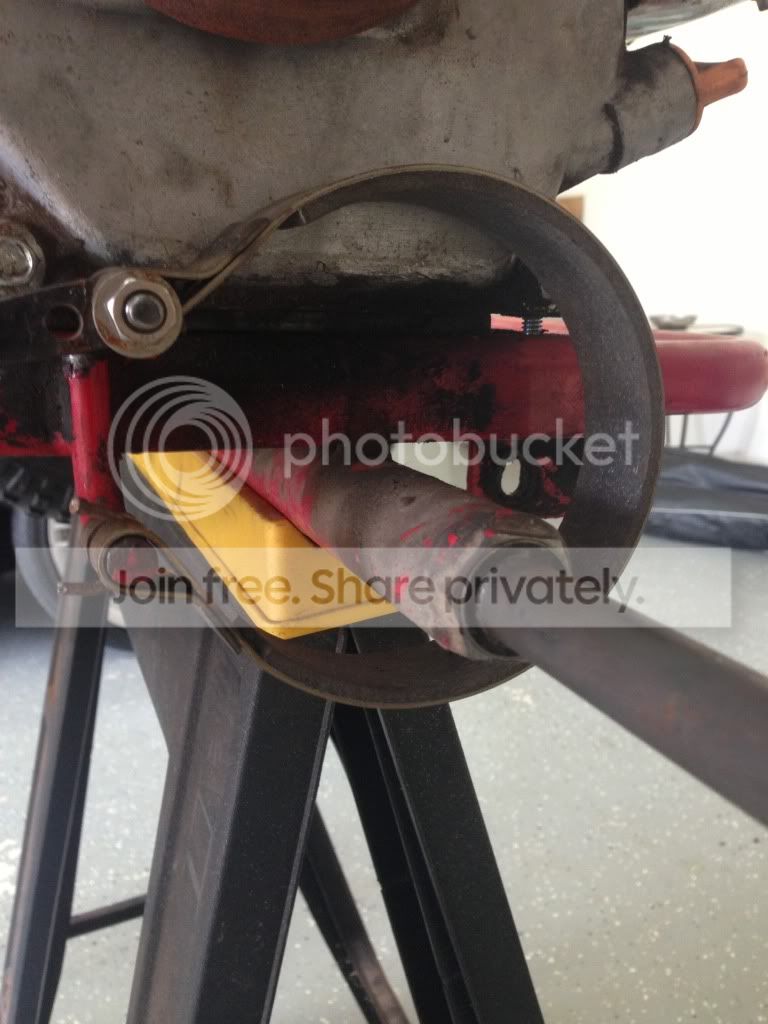

    new brake pad
    old brake pad

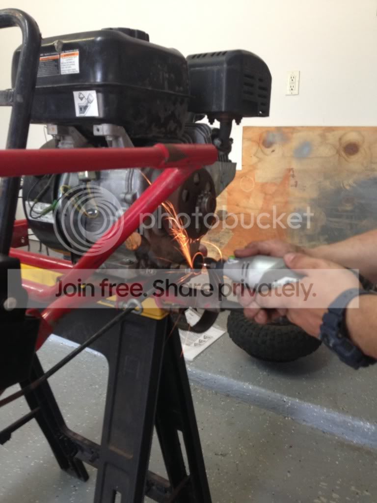

    had a problem with a bolt rubbing the sprocket so we had to cut it and grind it down with the handy off brand dremel lol

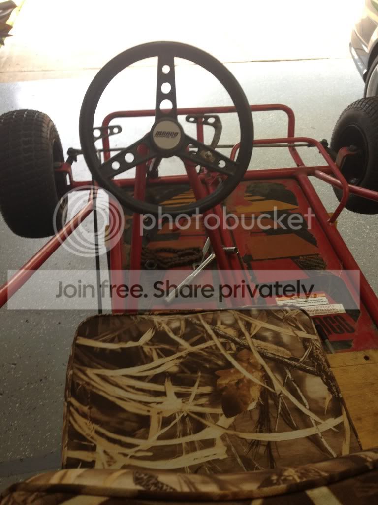

    POV shot :jester: notice the kill switch on the steering wheel

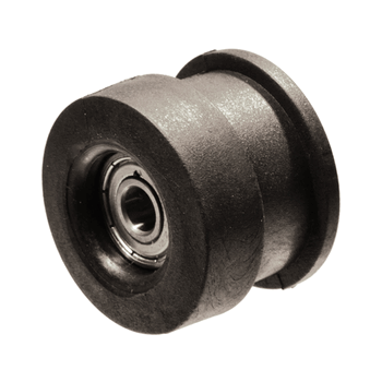

    Build a spring loaded swing bracket and get one of these
    for the chain.
    Still say it would be easier to cut a longer adjustment
    slot for the rear engine mount bolts.

    That was before we slid the motor forward. Lol. How would we mount that?
