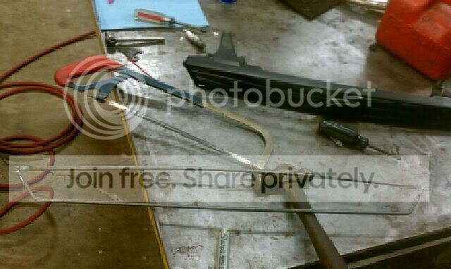

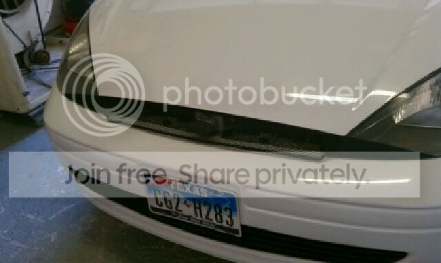

    do it man! me and a friend made a custom mesh grille for his focus. we picked up this metal mesh material at lowes and some support bar for the basic shape: (cellphone pics)

  5. TxFx04
    that's the cheap way if you don't wana fork out $200 for a grille. it was about $12 lol
  6. supercrewzn
    7,871
    I know exactly what he is talking about. Its called gutter guard and its cheap! Ive used it for grilles before.

  8. TxFx04
    but since your grille is 3x larger than a focus you'll need more support bar

  10. TxFx04
    a tig welder would come in handy, i tried tacking the mesh to the support bar with a mig and it burned through even on low amps lol
