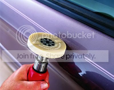

    There is another way of doing this. There is an eraser tool all it does is connect to your drill and you zip it right off. The tool starts at $10 and up.

  3. 01f1502wd
    easiest:
  4. Darth Bama
    This is my preferred way. Until you use one, you don't realize just how easy it is. :waytogo:
  5. 01f1502wd
    i was taking off my side mouldings and said F it, and got the drill and eraser out...saved soooo much time
  6. Darth Bama
    A TON of time. I did my truck in less then an hour, and that includes buffing it back out. :waytogo:
  7. UtahFord
    where do i get one??
  8. Darth Bama
    Some AutoZones sell a different version that works pretty good too. I've seen them at Autozone, Pep Boys and automotive paint supply stores.
  9. UtahFord
    i will check them out
