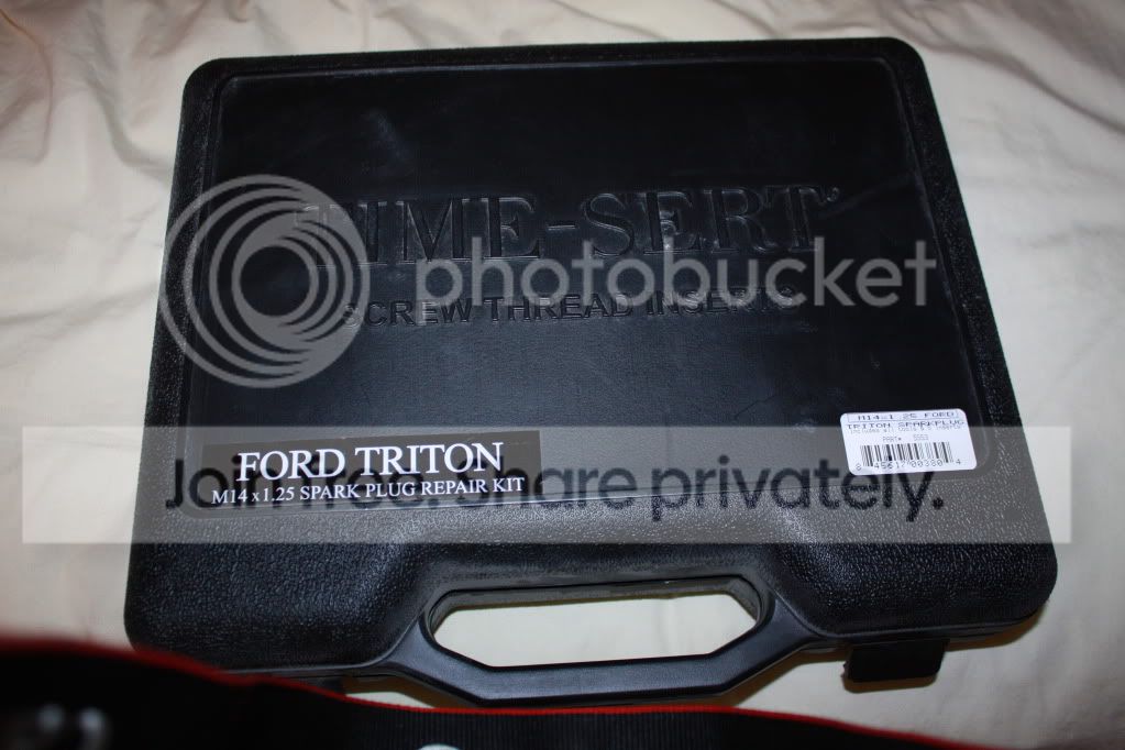

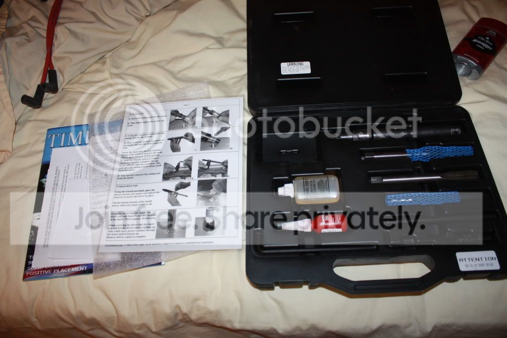

    selling my time sert kit. Need this thing sold so I can buy new brakes for my car and it wont let me post in the classys so here it is.

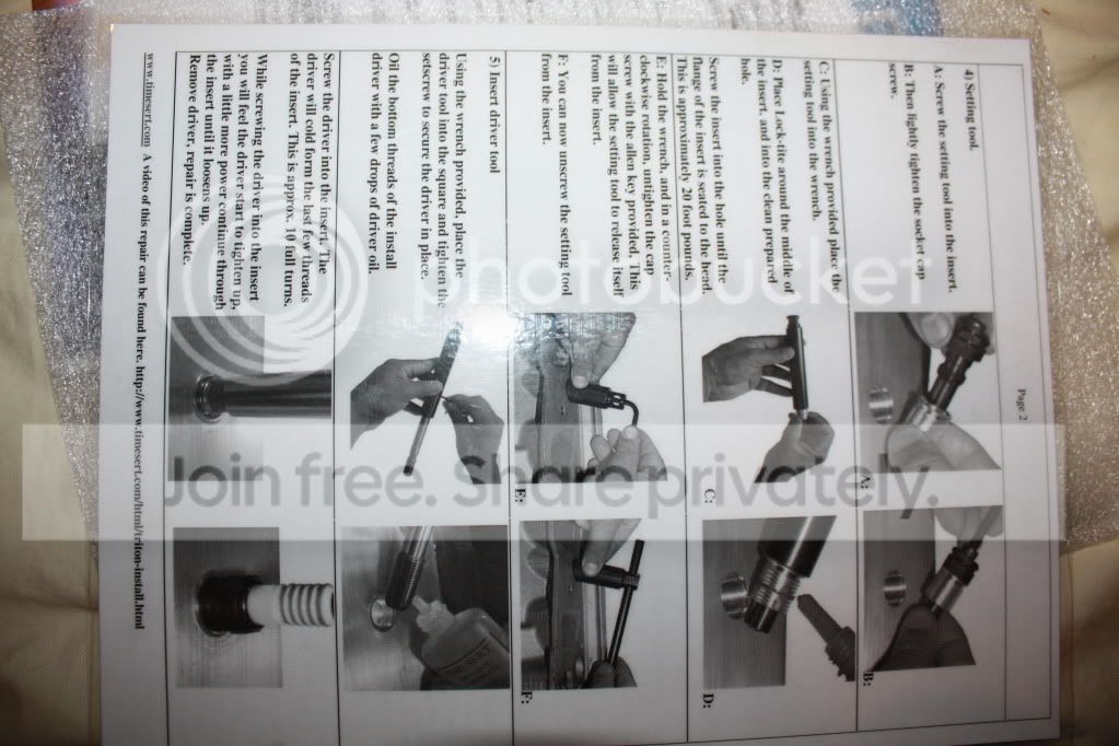

    everything is in amazing shape and works perfect. just need to buy replacement inserts to use because all of mine are installed into my engine. incase you dont know bout this kit check out this ++ Ford Spark plug Repair ++, ford spark plug blow outs, blow out spark plug ejection blow out, blown out sparkplugs, ford stripped spark plug, ford sparkplug blow outs, ford spark plug blowouts, ford defects, ford spark plug repair ford, ford spark . its the best way to repair a blown plug. period. And has amazing instructions. and its permenant. I paid $405 im asking $275 obo
    awesome for prevenntative maitanence as well, i blew two plugs but time serted all 8 cylinders so that it couldnt happen ever again.
    an heres some pics of the kit.

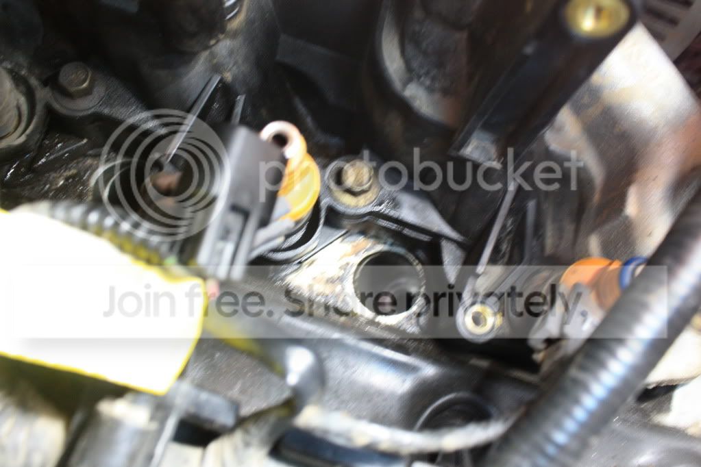

    heres what it looks like installed, hard to take a pic of it but thats the carbon steel insert flush mounted and installed
