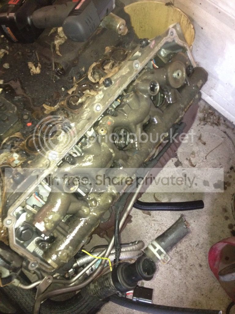

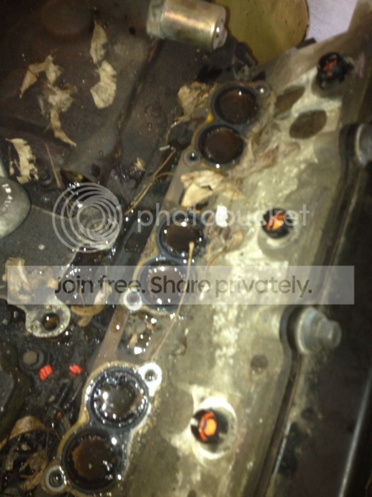

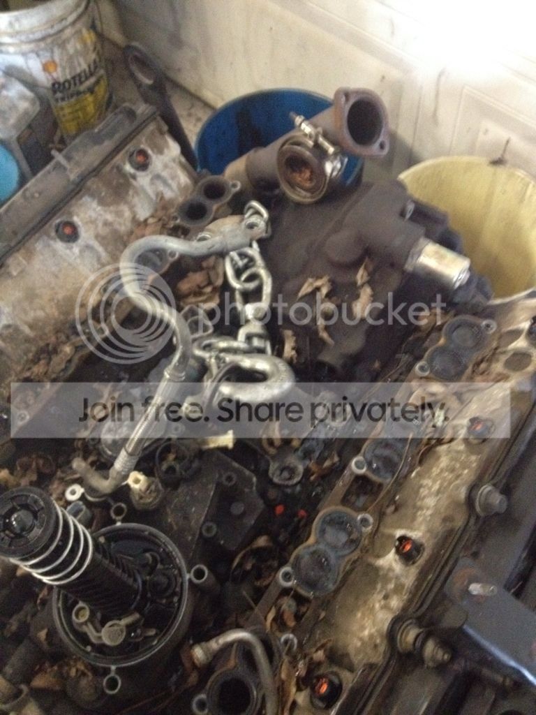

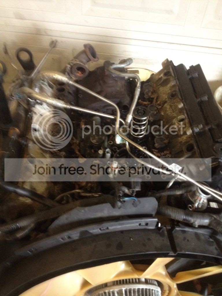

    Spent about 2hrs at the shop this morning and tore into it more. Got both valve covers off the intake manifold off and the Hpop and injectors out. Wanted to get the heads off but ran out of time. I'm less worried about then now as I found a rebuilder that takes them no matter what shape or cracked as cores.

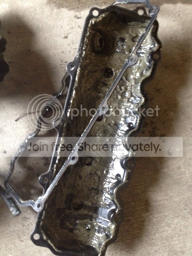

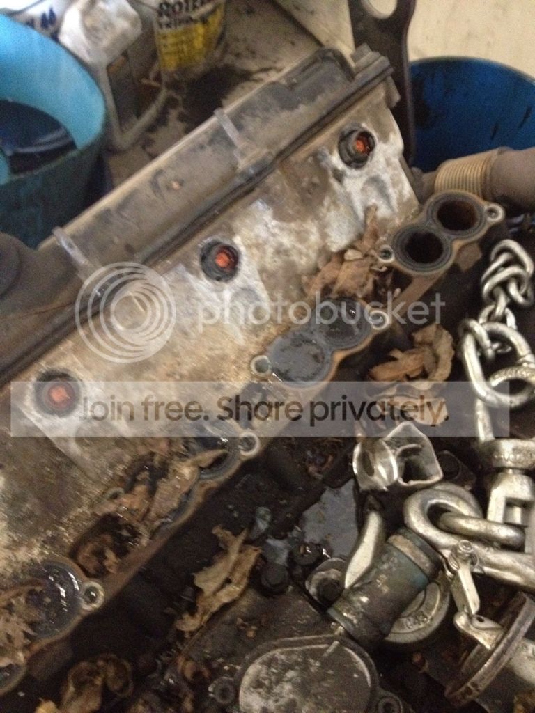

    Lots of water in the intake and the intake ports 6 out of 8 cylinders were full of water. Driver side valve cover was covered in gunk but the oil rails injectors and Hpop all still had good oil in them and the Hpop and cover were clean as was the passenger side valve cover.
    Next up is to start selling some parts and get new ones. Current turbo is probably already sold also once I swap the powermax on next Saturday.

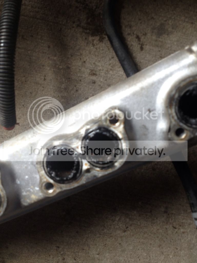

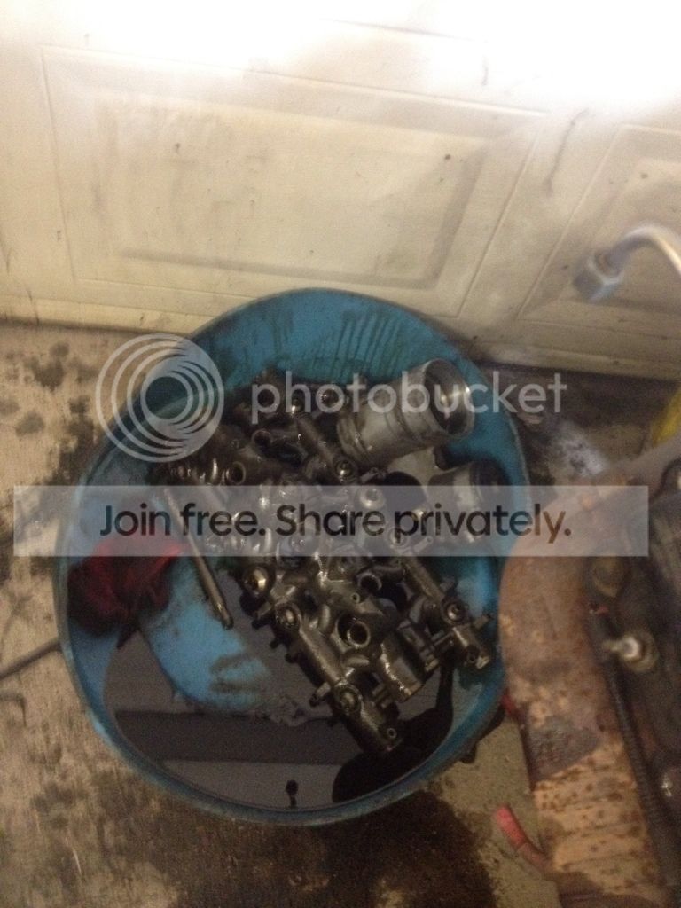

    Oil rails. In good shape with clean oil inside.

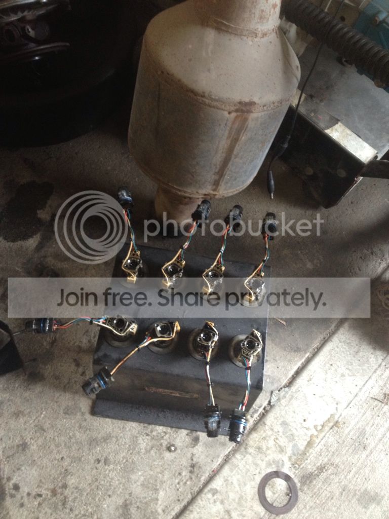

    Injectors. 2 are new remans

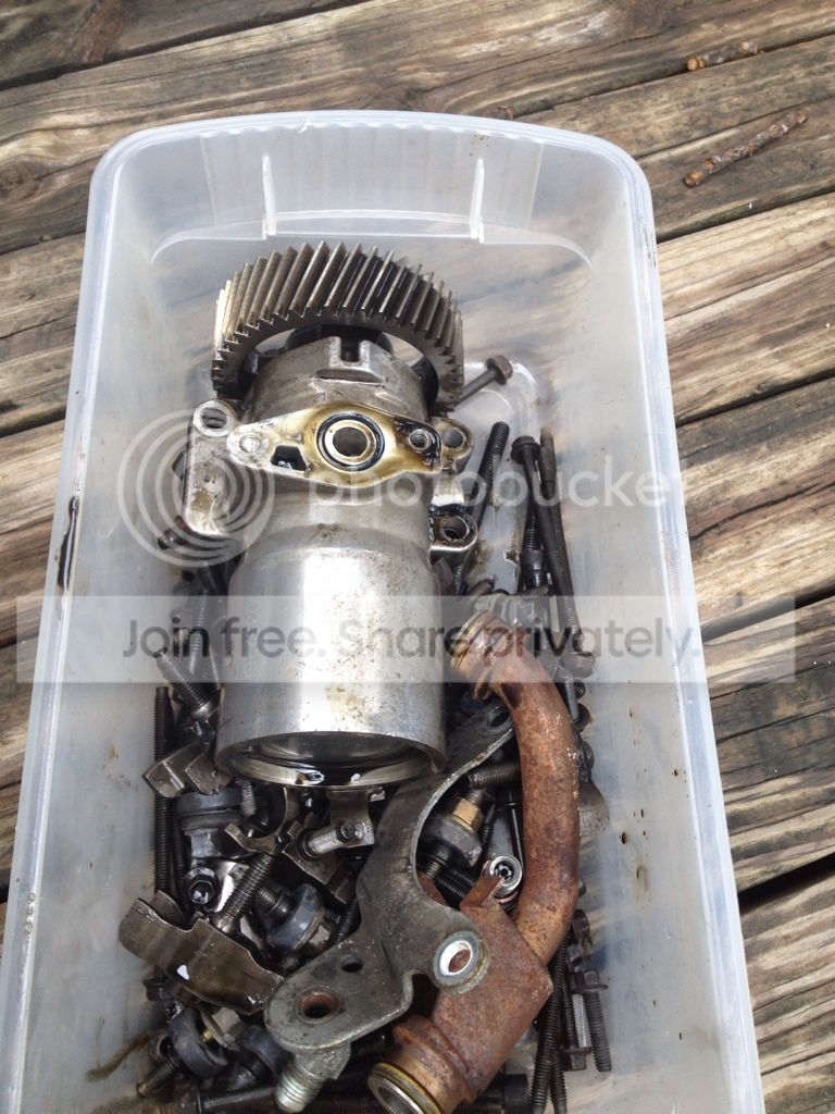

    hpop and bolts that came off

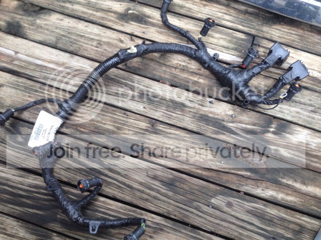

    good spare injector harness

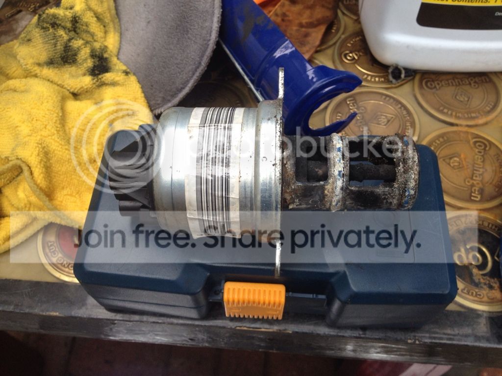

    good egr valve for someone with a delete and needing an egr valve to have plugged in only

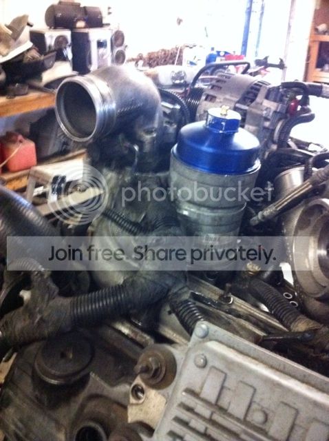

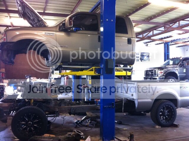

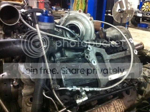

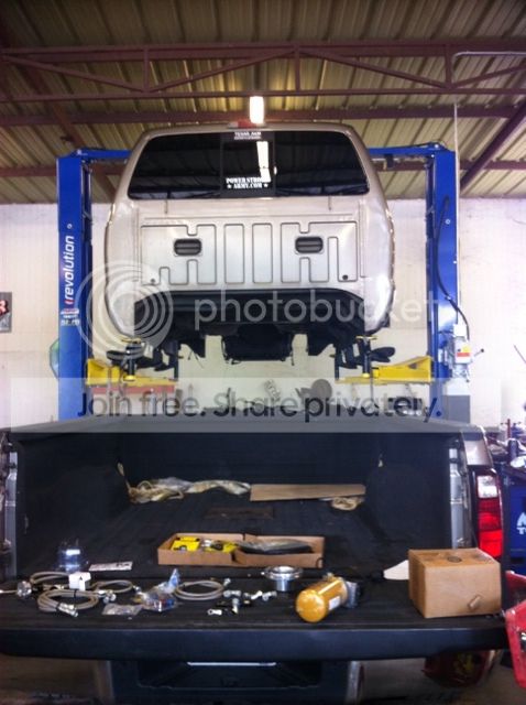

    got pics last night. finishing up the fuel system and its good to go. wont go get it till friday though.
    moar cab up
    Wheres the fuel bowl??
    Powermax and new lines being run

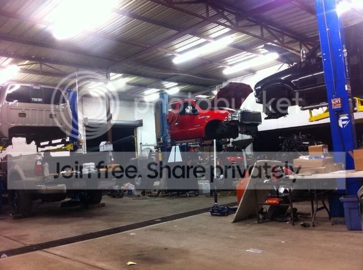

    Last night the shop at around 11pm

    So did something go bad with your 6.0 or did you just decide to drop in this motor?
  9. agjake11
    agjake11 Suck my tailpipe
    1,587
    Rosenberg/Baytown TX
    i bought a motor that took a dump and parted it out plus took parts i needed/wanted off it to have built prior to pulling the cab.
    Cab came off last thursday to rebuild the top end of my motor. nothing went bad but figured add power and reliability at the same time and save money.
