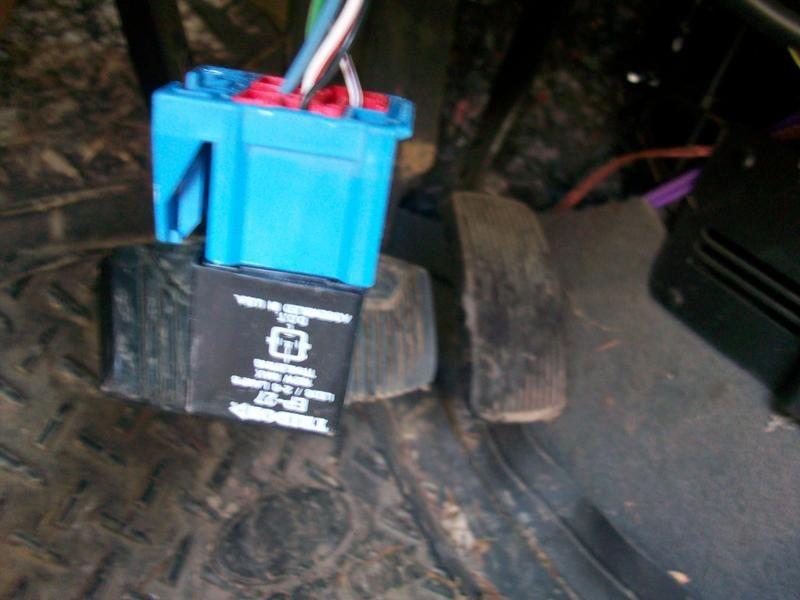

    for those of you wondering,
    i have these switchbacks: TYPE 2 DUAL COLOR CHANGING HID 5K WHITE AMBER SWITCHBACK 60 M-SMT TURN SIGNAL BULBS 3157 3157NA 3357 3457 4157 4057
    and this flasher, to correct the turn signal hyperflashing as a result of switching normal bulbs to leds for the turns: Buy Tridon (Novita Tech. Inc) Electronic Turn Signal Flasher EP27 at Advance Auto Parts
    v-leds also has a flasher that should work the same: http://www.v-leds.com/BlinkerWarning-Fix/Electronic-Flashers/5-PIN-ELECTRONIC-LED-p4810389.html
    is is located here in my truck and looks like this:
    jarrett, your turns are bulb 3157
    i will gladly answer any other questions you guys have :cheers2:

    so I think i will do alllll of my lights. for my taillights will i need that special relay? and what about the blinkers in my mirrors?

    if you get the flasher/relay, it will only be a one time install. it will fix flashing issues whether you have front turn leds, rear turns or both.
