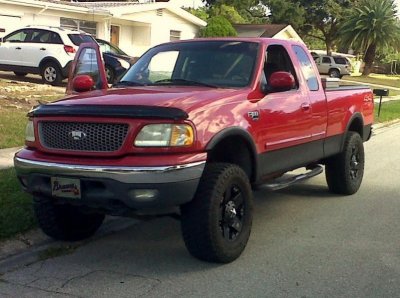

Thinking of painting my rims black

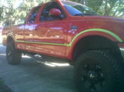

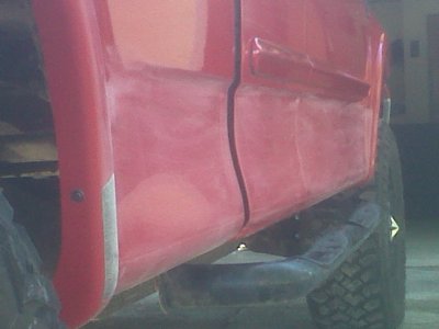

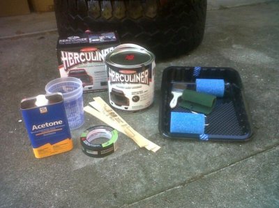

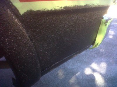

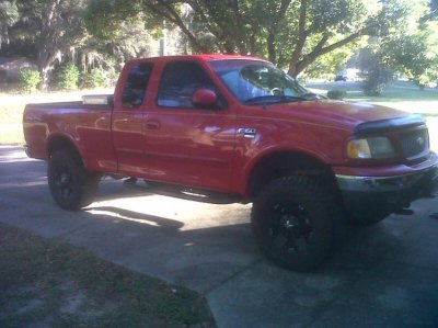

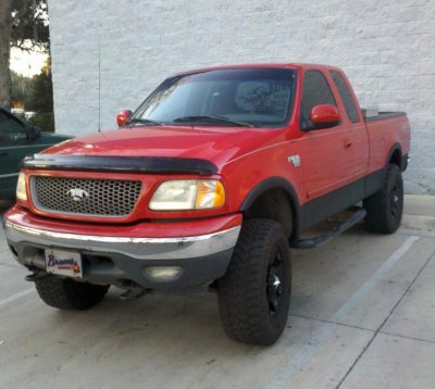

    and back off topic but who ever was asking about doing the rhino-line yourself or paying to have it done.. DO IT YOURSELF, it was easy and came out great. i paid $69.00 for the herculiner kit and you get a $20 mail in rebate so $49 and i did my truck, and the cab of my buddies toyota and still have 1/2 a gallon, toolbox is next when ever i get a day off..
    before and after

    looks good is it holding up good

    ya its damn sure not goin anywhere. it is nasty stuff goes on like road tar. very very rough stuff..

    rwilhite07 did you just mask off the flares or remove them from the truck? i have a red truck too and after seeing yours my mind is def made up im doing it myself....i plan on doing my bumpers as well though. that herculiner stuff is great i did the inside of an old jeep with it few years ago...truck looks great dude!

    Alright after much deliberation (Bigun that means talking about it) JK LMAO. I have decided to paint them myself, and i will take pics of the progress. Now to the second question i have access to a sand blaster do ya'll think if i left the tires on rims would the sand blasting screw my tires up or should i just do it the way of elbow grease and sand paper

    dgiancola, i washed and dryed my truck, then scuffed it with the pad that comes with the herculiner kit, masked it off, cleaned it with acetone, then rolled on coats. if ya got anymore questions just PM me or something and ill be glad to help but it was very very easy. i was hesistant to do it because its so permanent and didnt no how it would look but i wouldnt think twice about doing it again im 110% happy with it.
