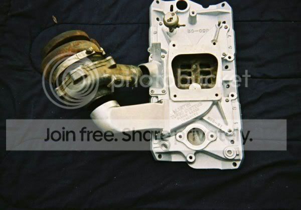

    Not strong enough?
  3. cowboy
    Depends on the aluminum alloy it maybe strong enough. But it will get way too hot.
  4. iowaredneck
    gets too hot
  5. jlyoung08
    looks like they both go inside the intake? idk how the turbo would really work the way its set up

    so it'd pull air out of the manifold...and tubes it right back in..?
  7. 01f1502wd
    ^thats what I was thinking..
  8. jlyoung08
    defeats the whole purpose

    It's a draw-through turbo. Fuel and air from the carb is
    compressed and sent back to the intake.
    Hope the seals are in good shape.
    That would make one hell of a flame thrower.
    There is a separate intake runner under the top piece.
    What I see missing are the flappers under the rectangular
    holes. The flappers opened during start up like reed valves
    and closed as turbo pressure was built.
    I read up on this Martin Turbo Systems intake:
    low boost pressure,
    5-10 lbs and no inter-cooler.
    Articles say they made great low end torque suitable for a tow truck but
    lacks top end performance.
