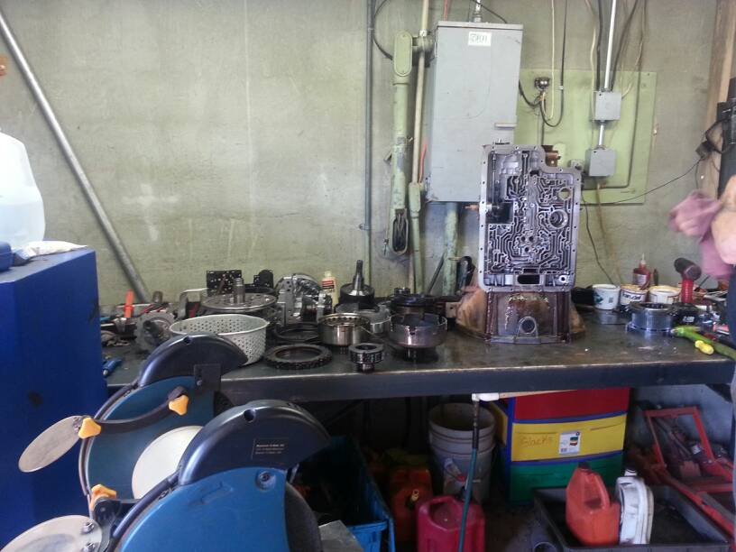

    Oh and good luck with a $70 rebuild...
    Im about 500 in on my e4od rebuild so far..
