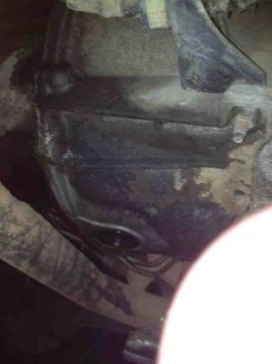

    When I pull the inspection cover, is there oil in there? And it's the two bolts towards the front the do I have to remove the bolts towards the front of the oil pan too?

    No theres no oil or trans fluid In there..
    Its at the bottom front of the trans right behind the motor.. if your under the oil pan and facing toward the rear end you should see it.. if I remember its 2 10mm bolts that hold it on

    Alright, I'll mess with that soon. The 10mm are the ones ImageUploadedByTapatalk1373556901.222410.jpg
    In the back on the trans?
