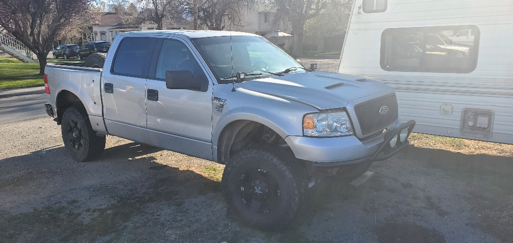

    Here's the truck. 2005 F-150 with upgrades already installed[​IMG]
