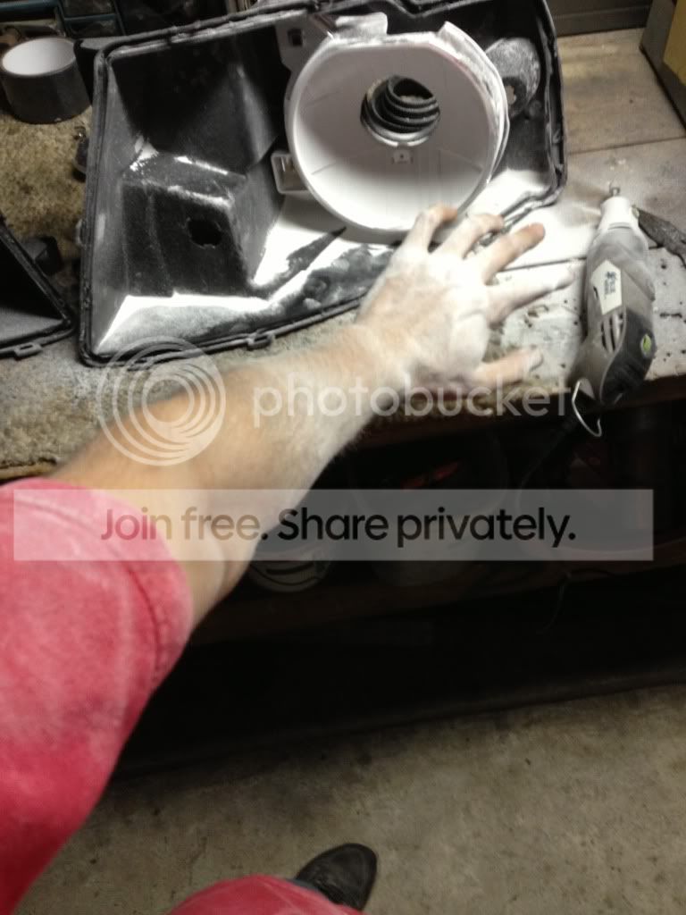

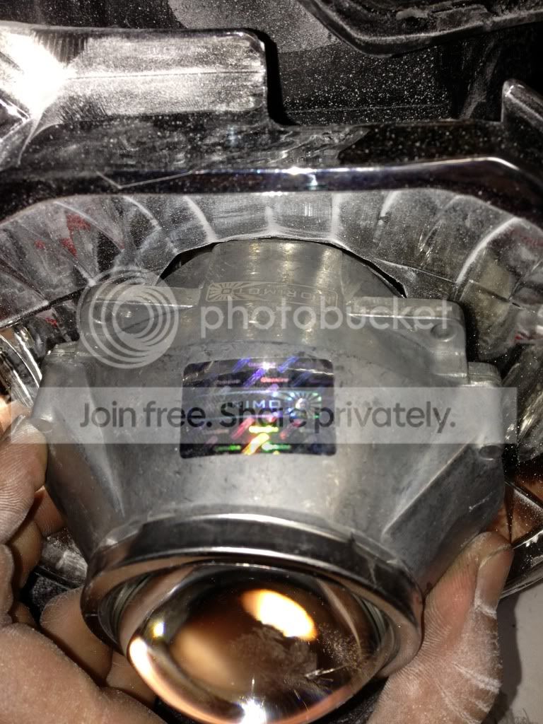

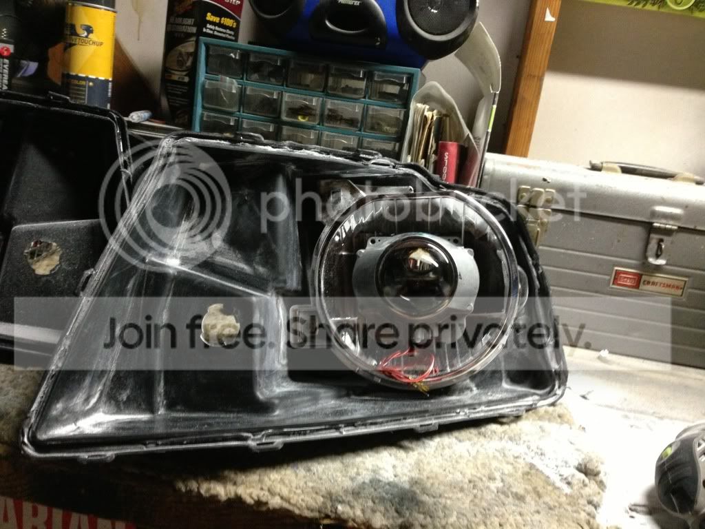

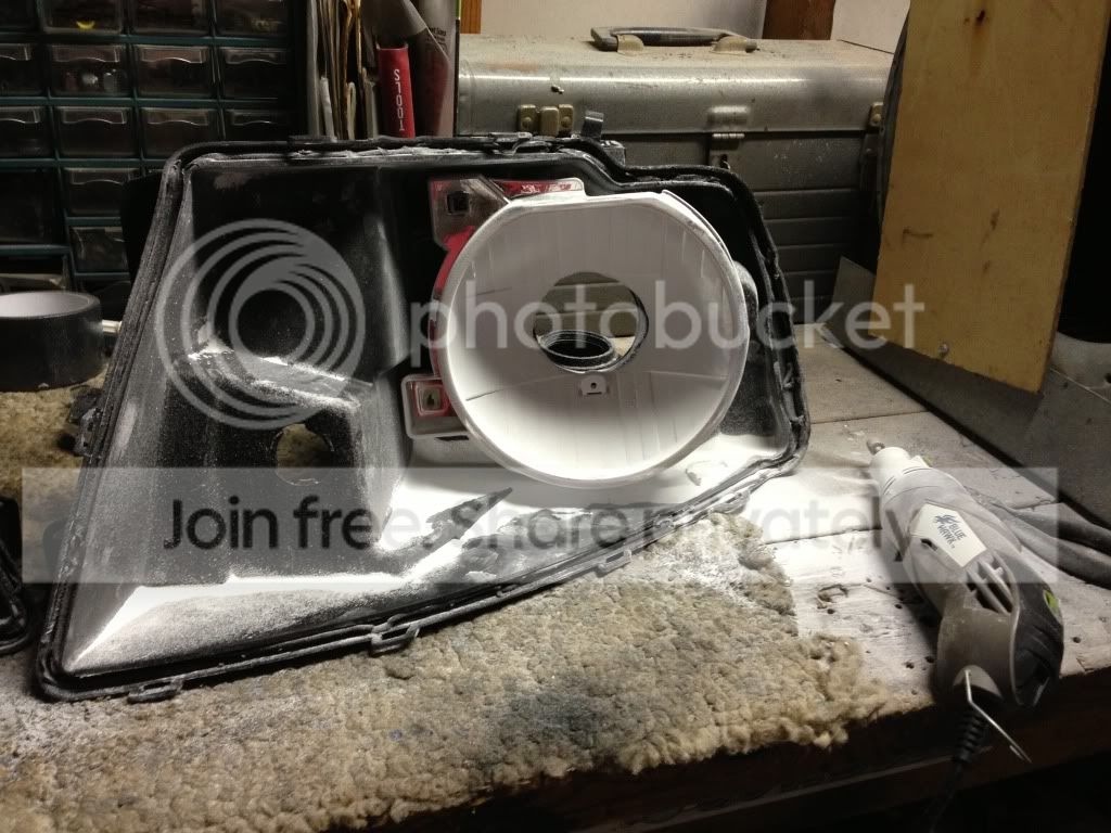

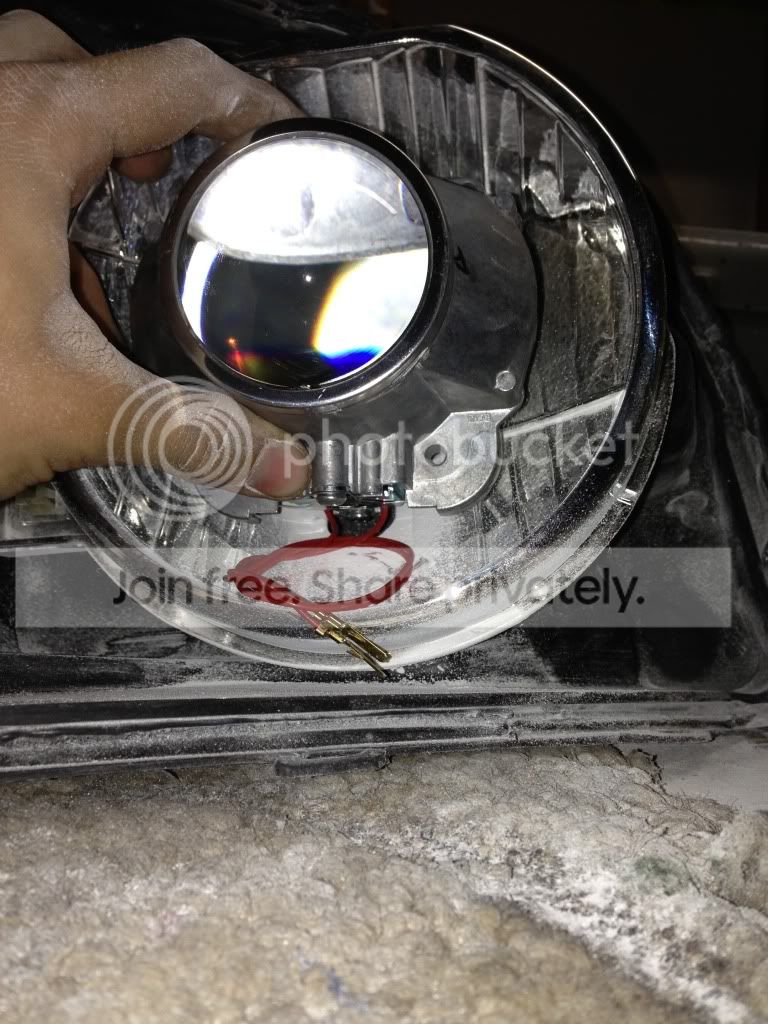

    well got one side trimmed up. i found out the projector isn't supposed to sit flush against the housing or it would hit my radiator support which is good because i have about 3/8" to spare. gonna mark my 4 holes tomorrow and drill them out then trim up the other side!

  5. TxFx04
    I'm gonna drill my holes to mount the projector, do the other side and paint the housings black. I may do some red touches since I still have some ptm paint but I don't want it to be overkill. May just do all black
  6. Roush PSD Interceptor
    Looking good there Dylan.
    Save that "magic dust" from the cut out.
    :lol2:
  7. VanoFord
    :facepalm: i cant believe you have that lens exposed to all that dust and you are just handling it like its no big deal
  8. Roush PSD Interceptor
    I say blow it out with compressed air,
    then wash down with 90% isopropyl alcohol
    from a spray bottle as many times as it takes to
    get it clean.
    Micro fiber cloth if ya feel it has to be touched to
    get it clean for paint prep to black it out.
