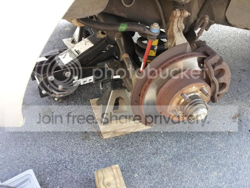

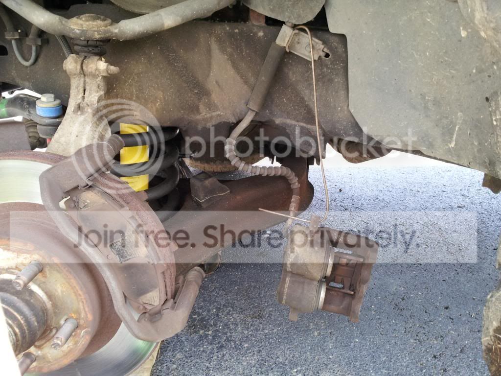

    Wheel is off. Upgraded to the larger Roush sway bar and newer all metal end links this past year.

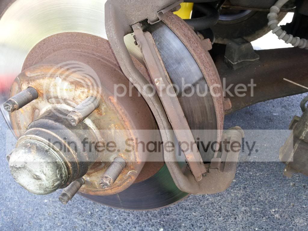

    Custom wire hanger for the caliper.
    Not quite down to the wear notch in the center of the old pads.

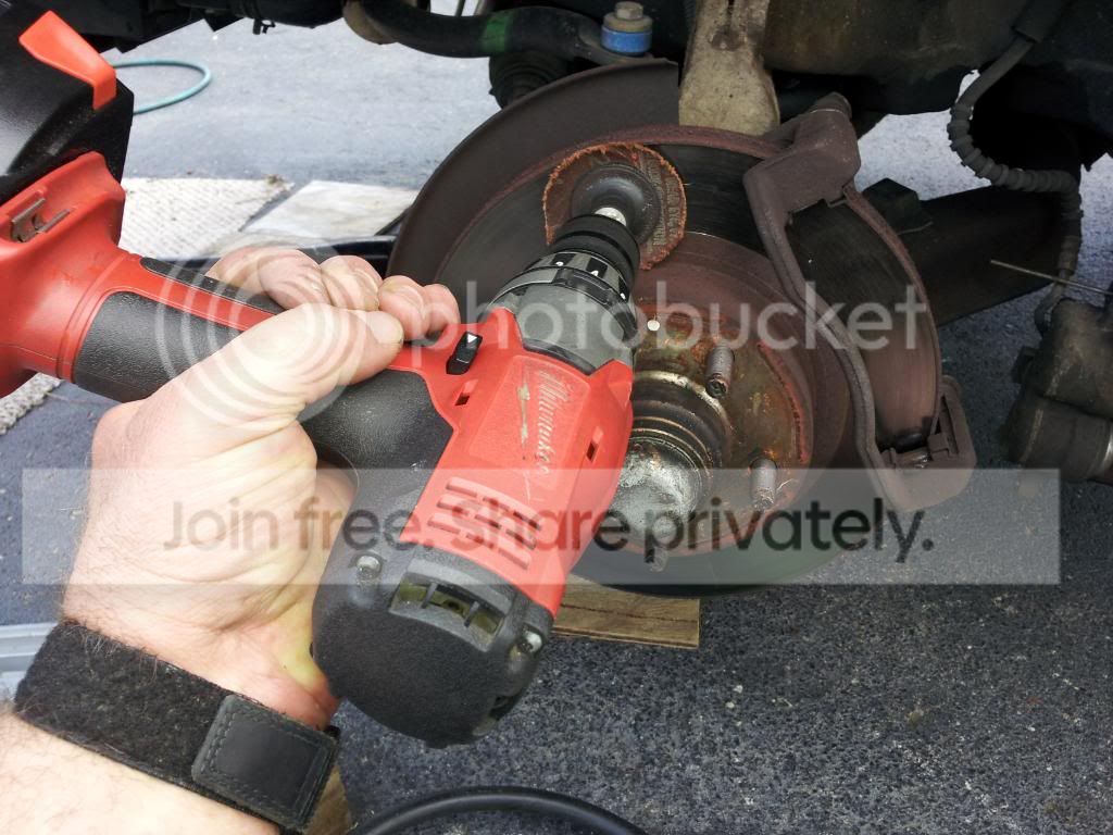

    Non directional finish rotor resurfacing equipment. Not so easy doing the inboard side.

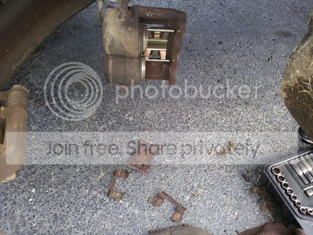

    Off with the old hardware, on with the new.

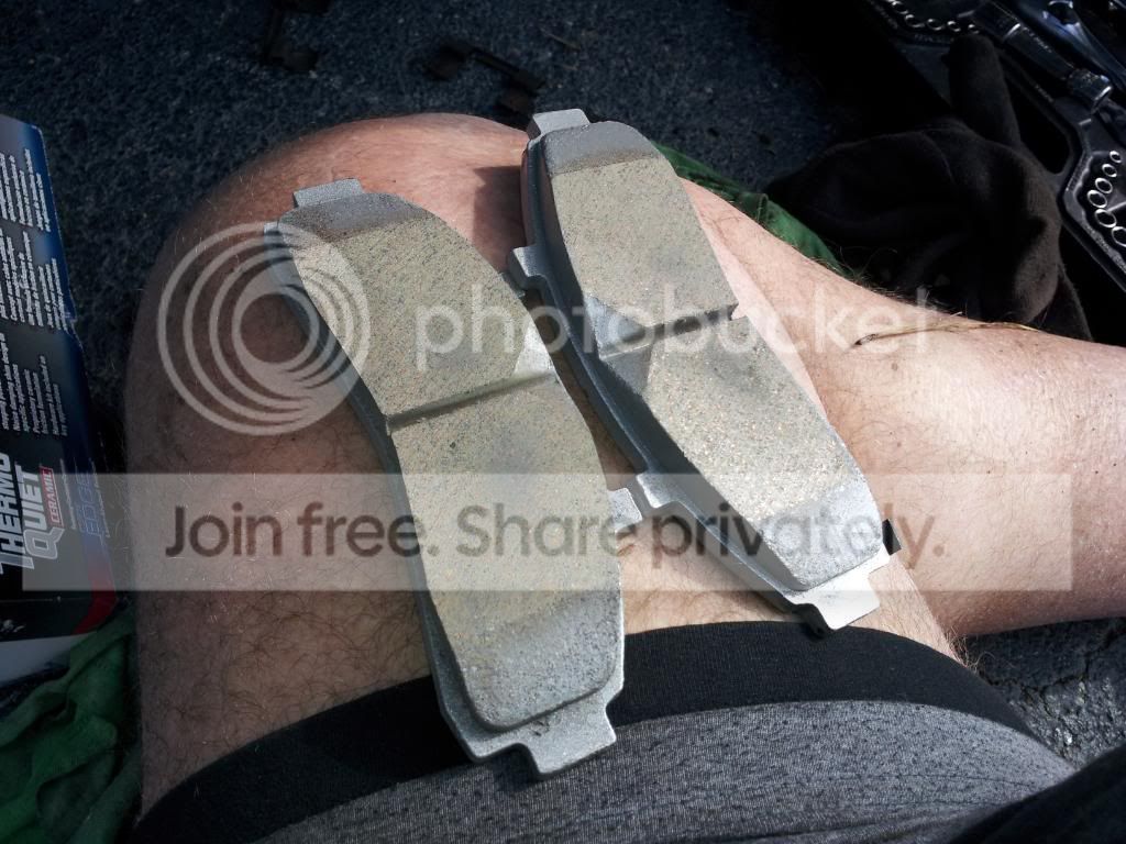

    New meat for the twin piston calipers.

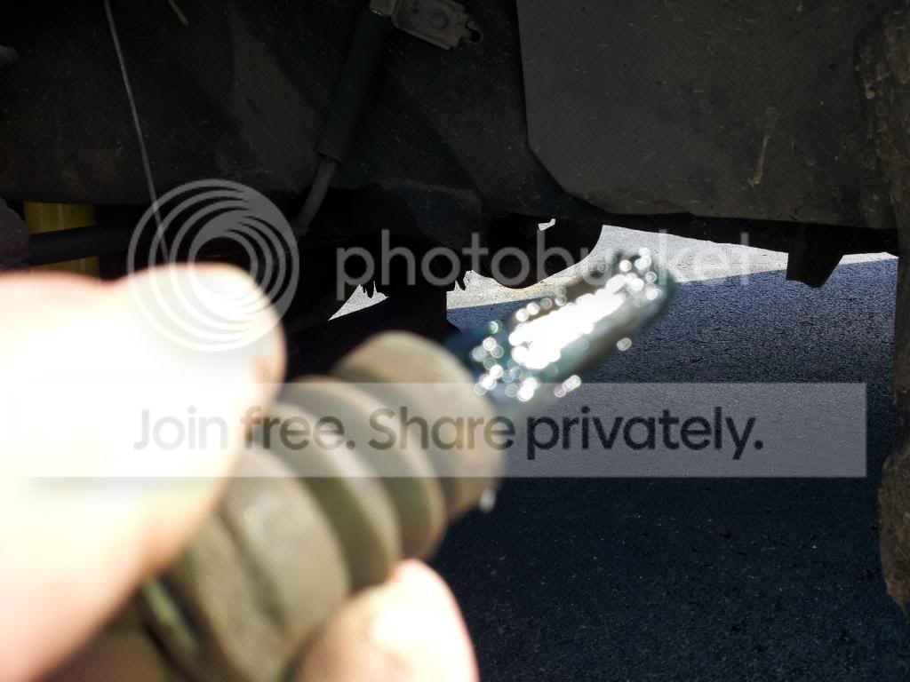

    Don't forget to ultra lube the caliper slide pins and wash evreything down with brake parts spray cleaner waiting for it to dry completely.
