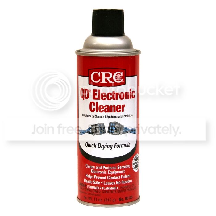

    I'd check the contacts on the switch first. My driver's side window did that a while back and I was about to order a new switch, luckily I checked it first. The contacts had become corroded fairly bad. Cleaned em, made a slight adjustment and it's worked great ever since. Never hurts to check...
  9. TxFx04
    ^ that. I had mine act up recently, I pressed the button and could hear the motor trying but it just wouldn't move. Popped the switches off and Got some of that CRC electronic cleaner and sprayed it and they work fine now
  10. Roush PSD Interceptor
    58
    This is cheaper than a switch.
    Worth a try before investing in switches.
    Sold at Wal-Mart or auto parts retailers.
    CRC QD Electronic Cleaner
