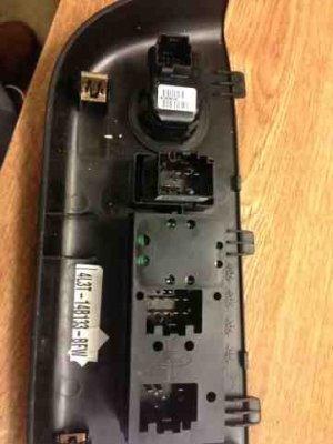

    Here's a picture of my drivers side panel, they don't seem that corroded?
  4. Roush PSD Interceptor
    58
    The switch contacts are hidden inside the
    housing under the buttons and past those prongs
    you see on the underside.
    I wouldn't recommend disassembly of the actual housings
    where the switch contacts are.
    Spray the CRC in the areas past those contact prongs
    that the wiring harnesses connect to.
    Sometimes there a tiny holes in the housing of the
    contacts that the straw tube on the CRC can penetrate
    to clean what is inside you can't see.
    Before plugging the harnesses back in, put dielectric grease
    on the metal contact points of the harness.
    Spray under the buttons on the top side also.

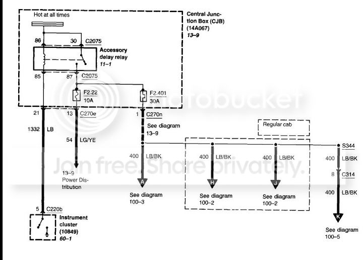

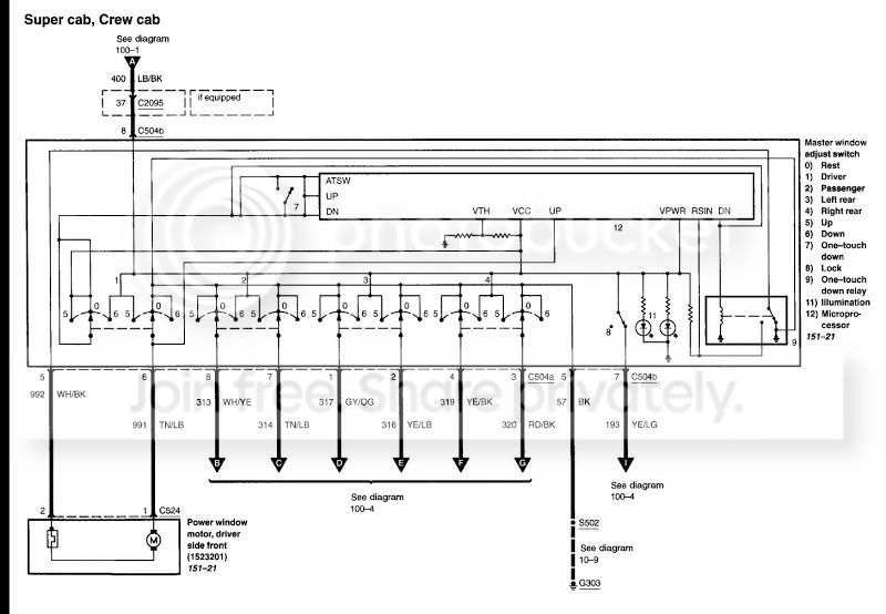

    Found the wiring diagram for a 2004 F150
    Of course there is a microprocessor inside the master switch. :facepalm:
